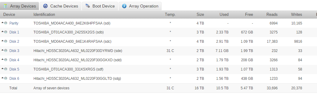

The issue first popped up in B14 after doing some maintenance on my array.  2 x 4TB drives were purchased, one of these was used to replace by 3tb parity drive, and then my two oldest drives were replaced with these 2 drives, the 3tb and 4tb.  I also used this opportunity to migrate all array disks to XFS.  It was only after moved to XFS that i started noticing the problem, up until then b14 had been very good.  I have now moved to beta15 and the issue still persists.
As you can see from the attached screenshot all array drives are spun down, disk 3 is still reported it's temperature and it is also reporting 'disk activity' in the syslog when i turn on debugging for s3 sleep.
All cabling has been doubled checked, and i replaced the sata cable on disk 3
If i manually spin up all drives and then manually spin them down then the issue goes away.  It was is most often reported on disk 3 but occasionally disk 1 and disk 2 so i don't really think the drive is at fault.

Just observing things again today, I don't understand the inner workings enough to know for sure but it seems the disk is getting out of sync with the others in regards to its temp and spun up/down status.
When the server is woken up after a period of time all the disks are getting spun up except disk 3 (because its currently empty and the mover hasn't chosen to start writing to it yet).  After the polling_attribute timer all disk temps are read including the disk that is spun down (disk 3). Now after some inactivity all disks will be spun down and temps will stop being reported by the GUI.  The drive that was not spun up will continue to report its temp until I finally spin it up manually and either let it spin down on its own or spin it foen manually.
issue still persists, all disks will be spun down in the GUI, but 1 disk (sde) will still be reporting 'disk activity' according to the debug for s3_sleep.
Does anyone have any idea how this is possible if the disk is spun down?
Please disable all plugins, run tests again, and report back with another syslog.  You have a lot of plugins installed which may have something to do with this.
here is a syslog with docker disabled and all plugins removed except s3_sleep. I have kept this installed as this is what im using to check on the mystery disk activity
In this syslog, rebooted server, waited 5mins, manually spun down all disks, observed that disks were spun down, manually put server to sleep, manually woke up using WOL, checked all disks were still showing as spun down.  At 7.05am enabled s3 debug logging and disks are still spun down but disk activity is being reported.  This is in fact before any temps have been taken so this may have just been confusing the issue previously.
To summarize the issue occurs if a disk has not been spun up after waking from sleep.  Even though the disk is spun down in the gui it incorrectly is reporting disk activity for some reason.  Manually spinning the drive(s) up always fixes the issue.

reggierat,
My problem was exactly the same as you described including the disk activity in the logs and messed up temp display.  Before S3 Sleep activates, the drives are spun down but when awoken, all drives are spun up as power is applied to them. The problem is that unRAID still thinks they are spun down so never starts its timer to spin them down and S3 Sleep checks the drives directly and sees if any are spinning and thus the constant log entry of drive activity and reset of its timer. In my case, drive sdb showed activity until I accessed file on it and unRAID spun it down normally then sdc began showing up as active in the logs.
Either spinning all the drives up or down manually will sync the drives actual status to unRAID and allow S3 Sleep to work properly as you have noticed.  The command you posted works perfectly as long as you let S3 Sleep do the sleeping as doing it manually is direct and bypasses everything.
