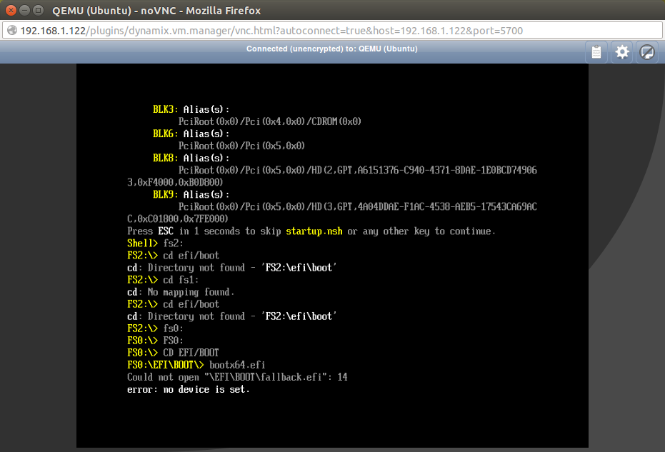

See efi1.png (attached).  When running OVMF I am able to install Ubuntu desktop 12 LTS all the way through reboot.

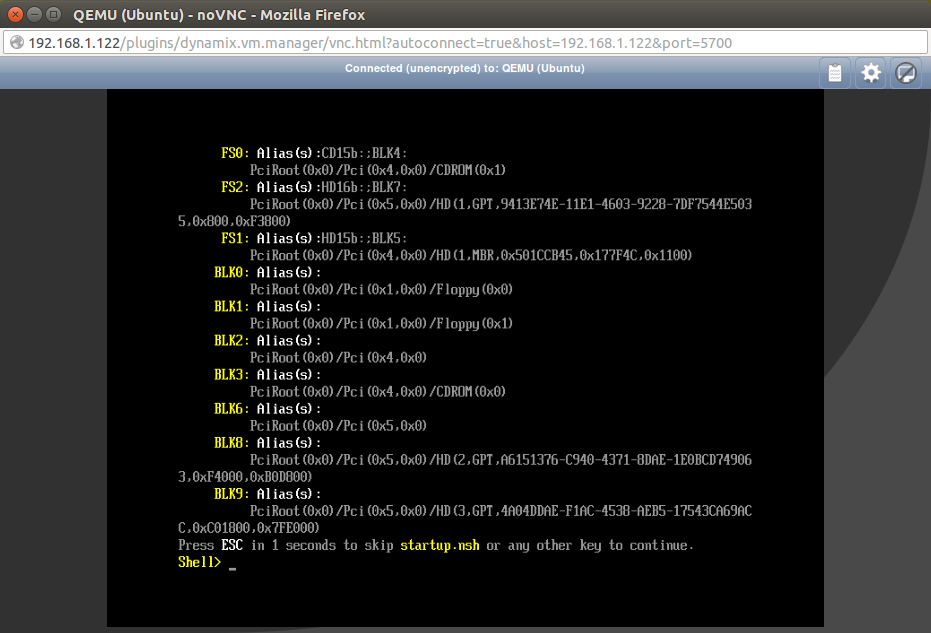

Upon the second boot FS1: and FS2: does not contain efi/boot (see efi2.png)
FS0: has efi boot, but shows the failure [glow=red,2,300]"Could not open "\efi\boot\fallback.efi":14 error: no device is set"[/glow] then immediately goes back to the ubuntu install.
Any thoughts on how to skip the shell and boot from the uefi/vm.hdd?
Thanks
