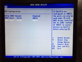

I'm trying to switch to AHCI on SATA ports 5 &6 but the BIOS says it's not possible.  When I do set it to AHCI, it won't boot.
If I physically rewire to put those drives on the main board (SATA 1-4) will I prevent full recovery? I'm pretty sure no, but just want to confirm before I start rewiring.
So you're saying there is an AHCI choice, but it won't let you select it?  Or that you can select it, but it won't boot?  Any choice is better than IDE anything.  But make sure that you check the boot order first.  Some (many?) motherboards try to *help* you by switching the boot order when a major change is made to the attached drives and/or drive controllers.  That often causes the system to fail to boot.  Try selecting AHCI then setting once more the boot order so that your flash drive is first to boot.  BUT see below...

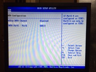

Please see the literal screenshots I've attached. Look to the top right corner about the warnings about switching.  After I switched to AHCI then it won't boot (goes to flashing cursor in top left corner). When I switch back to IDE it boots.
So better to leave everything just where it is, including the IDE BIOS choice, until any disk recovery is complete.  At least, it makes finding the drive symbol easy for Disk 4, it's hdd.
What does the warning say? The screenshot is too small to read. In BIOS, after changing to SATA make sure that the flash is still selected at the boot device.
Done. Please find it attached.
Switching to AHCI should make the system faster and more stable but should not be required for recovery. The flashing curser is the BIOS looking for a boot device. Changing to AHCI requires that the boot device be selected again on your MB.

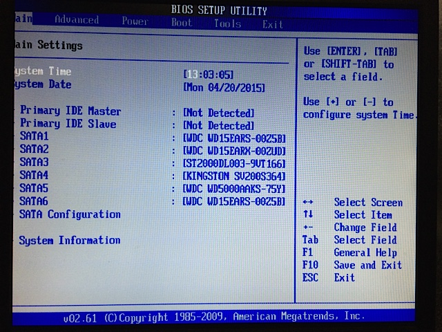

First I tried setting to AHCI again, and then updated the Boot device back to the USB drive so it would start up (thanks dgaschk).
However, when the client shows that two disks are missing so the whole thing doesn't mount.  I've attached two screenshots of the mainpage of the BIOS when I switch to AHCI and when I switch to IDE.  IDE allows me to start the array, but things go awry like I note above.
ok, will not let me post the files. too big so I will find another way to send the screenshots (to be big enough to read).  Here they are on Google drive  https://drive.google.com/folderview?id=0B6aGoLYlJ5VjfmdpSEFfM1A0NnZRS0J5Q3U0eXV5Ylkyam1zdDFhSk1TNlRRdW5YVVV6MVU&usp=sharing

The warning is BIOS is not a problem because unRAID has AHCI drivers. The warning is meant for for Windows XP users.
If the SATA ports are set to AHCI and the flash is then re-assigned as the boot device, does the system start up?

Did you have a chance to review my screenshots?
Any other suggestions for how to get this to work? I can now start to rewire (by un-assigning the drives and then re-assigning them after physically rewiring them)
The screens look great, just what we expected and wanted, so it's surprising it doesn't boot.  Can you double-check once more the boot order for your flash drive, make sure it is still first?
