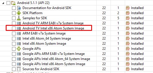

April 20, 201511 yr Author I started here, but I haven't seen much about Android TV. http://www.android-x86.org/ Youtube video. Lollipop, non-tv version, but still proof of concept. 4.4 install instructions, but probably still pretty similar. http://forum.xda-developers.com/showthread.php?t=2703270 I have qemu-img files from the Android SDK, which you can get from here. (Also where I got the screenshot) https://developer.android.com/sdk/index.html I do have the Android SDK emulator running Android TV in a VM, but no google play services just cause I don't know how to integrate them. I'm very green on this Android Developer stuff. But I was able to get the new Emby app for Android TV working in it (minus video playback for obvious reasons). I found the API 21 was running better than the API 22, so I'd probably start with API 21.

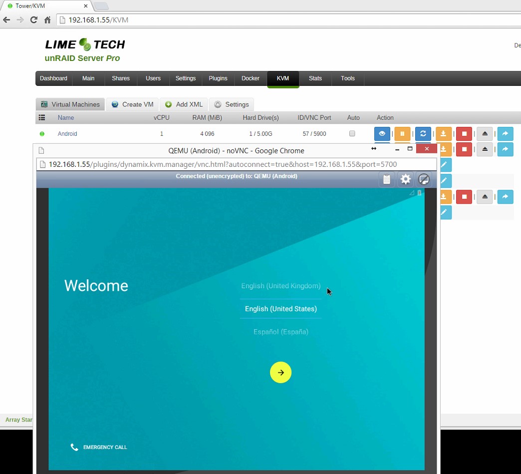

April 20, 201511 yr Author Barebones Android Lollipop 5.0.2 is running on Unraid! No hardware passthrough or anything. Here is the xml: <domain type='kvm' id='57'> <name>Android</name> <uuid>fc6b55c8-b219-49c2-368d-40bdb0076cdb</uuid> <memory unit='KiB'>4194304</memory> <currentMemory unit='KiB'>4194304</currentMemory> <vcpu placement='static'>1</vcpu> <resource> <partition>/machine</partition> </resource> <os> <type arch='i686' machine='pc-q35-2.1'>hvm</type> <boot dev='hd'/> </os> <features> <acpi/> <apic/> <pae/> </features> <clock offset='localtime'> <timer name='rtc' tickpolicy='catchup'/> <timer name='pit' tickpolicy='delay'/> <timer name='hpet' present='yes'/> </clock> <on_poweroff>destroy</on_poweroff> <on_reboot>restart</on_reboot> <on_crash>restart</on_crash> <devices> <emulator>/usr/bin/qemu-system-x86_64</emulator> <disk type='file' device='disk'> <driver name='qemu' type='raw'/> <source file='/mnt/disk/samsungvms/Android/Android.img'/> <backingStore/> <target dev='hda' bus='virtio'/> <alias name='virtio-disk0'/> <address type='pci' domain='0x0000' bus='0x02' slot='0x03' function='0x0'/> </disk> <disk type='file' device='cdrom'> <driver name='qemu' type='raw'/> <source file='/mnt/cache/iso/android_x86-5.0.2.iso'/> <backingStore/> <target dev='hdc' bus='sata'/> <readonly/> <alias name='sata0-0-2'/> <address type='drive' controller='0' bus='0' target='0' unit='2'/> </disk> <controller type='usb' index='0' model='ich9-ehci1'> <alias name='usb0'/> <address type='pci' domain='0x0000' bus='0x02' slot='0x02' function='0x7'/> </controller> <controller type='usb' index='0' model='ich9-uhci1'> <alias name='usb0'/> <master startport='0'/> <address type='pci' domain='0x0000' bus='0x02' slot='0x02' function='0x0' multifunction='on'/> </controller> <controller type='sata' index='0'> <alias name='sata0'/> <address type='pci' domain='0x0000' bus='0x00' slot='0x1f' function='0x2'/> </controller> <controller type='pci' index='0' model='pcie-root'> <alias name='pcie.0'/> </controller> <controller type='pci' index='1' model='dmi-to-pci-bridge'> <alias name='pci.1'/> <address type='pci' domain='0x0000' bus='0x00' slot='0x1e' function='0x0'/> </controller> <controller type='pci' index='2' model='pci-bridge'> <alias name='pci.2'/> <address type='pci' domain='0x0000' bus='0x01' slot='0x01' function='0x0'/> </controller> <interface type='bridge'> <mac address='52:54:00:cf:91:6d'/> <source bridge='br0'/> <target dev='vnet2'/> <model type='virtio'/> <alias name='net0'/> <address type='pci' domain='0x0000' bus='0x02' slot='0x01' function='0x0'/> </interface> <serial type='pty'> <source path='/dev/pts/3'/> <target port='0'/> <alias name='serial0'/> </serial> <console type='pty' tty='/dev/pts/3'> <source path='/dev/pts/3'/> <target type='serial' port='0'/> <alias name='serial0'/> </console> <input type='mouse' bus='ps2'/> <input type='keyboard' bus='ps2'/> <graphics type='vnc' port='5900' autoport='yes' websocket='5700' listen='0.0.0.0'> <listen type='address' address='0.0.0.0'/> </graphics> <video> <model type='vmvga' vram='16384' heads='1'/> <alias name='video0'/> <address type='pci' domain='0x0000' bus='0x00' slot='0x01' function='0x0'/> </video> <memballoon model='virtio'> <alias name='balloon0'/> <address type='pci' domain='0x0000' bus='0x02' slot='0x04' function='0x0'/> </memballoon> </devices> </domain> In order for it to boot properly, I needed to remove the input devices, otherwise, I pretty much made a stock image with VMman. <input type='tablet' bus='usb'/> <input type='mouse' bus='ps2'/> <input type='keyboard' bus='ps2'/> I used the Android x86 image from here: https://drive.google.com/file/d/0B4VR-WNTOX0qVnkyWExEZHdLTms/view I was directed there from guides, I did not upload that. I also had to select Raw for the HD type. The "Android is upgrading # of 66 apps" took over an hour to complete, and going through initial setup is terribly slow. Trying to create a new vm with different settings to see if it performs better. First one I used was with 32-bit settings, as I believe it is necessary. Secondary one is 64-bit. Thought I'd post an update. ETA: First boot after install, make sure to select Debug mode. It'll hang at a few spots during loading. Type "exit" to get past it. Basically, you can't remove Mouse and Keyboard from the XML and it can't load those drivers so it hangs. If you type "exit" after it hangs, it bypasses the driver and continues! Android is Upgrading now on 64-bit!

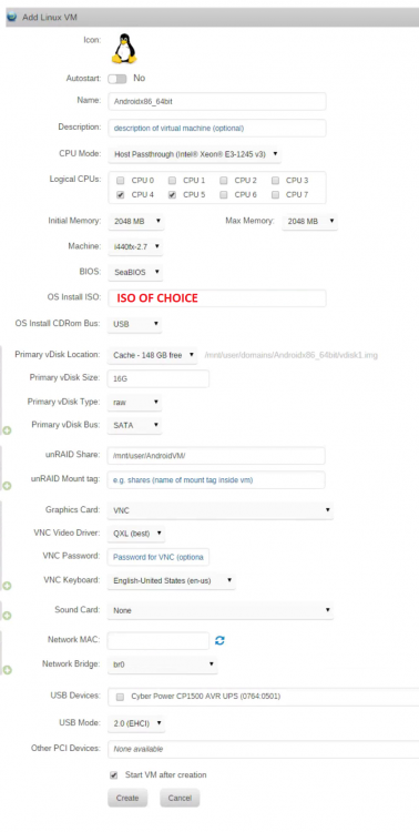

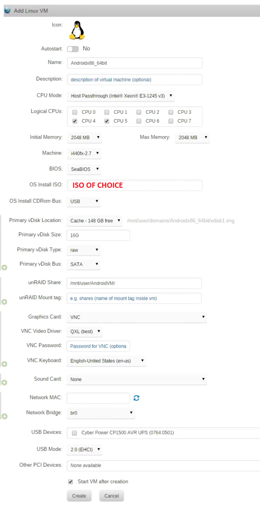

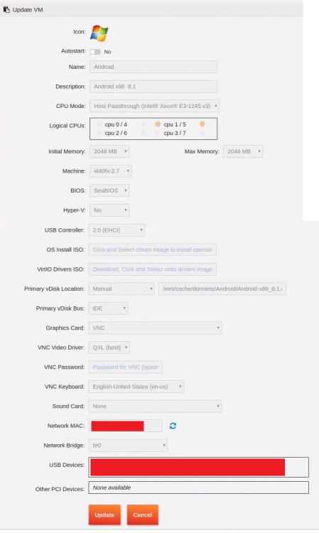

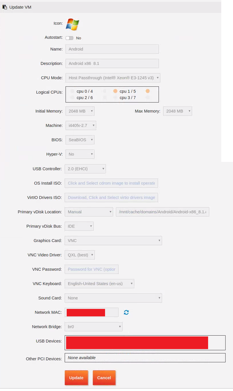

August 31, 20178 yr Here are the settings I used to get Android working in UnRaid 6.3.5: Navigating around in VNC is a bit of a pain though. Edited August 31, 20178 yr by kimocal remove MAC address from image

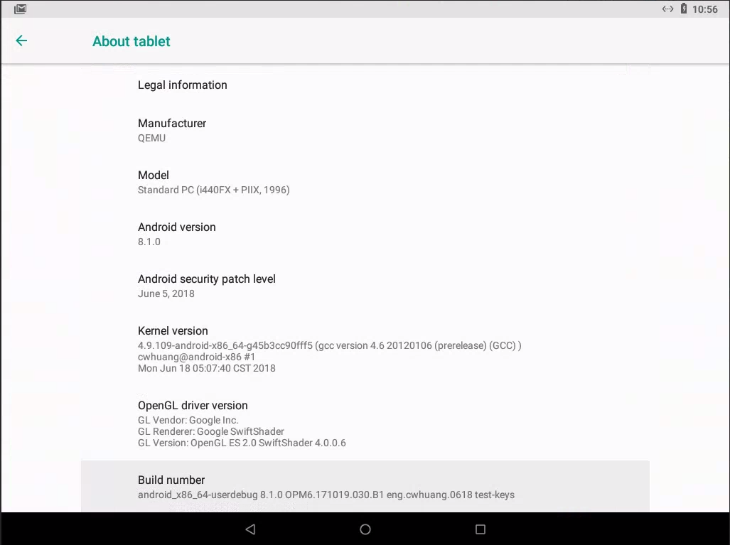

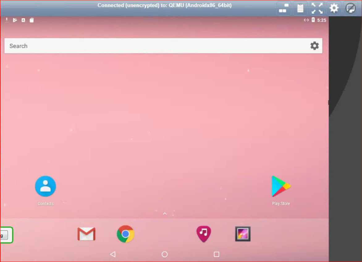

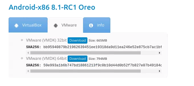

October 18, 20187 yr On 7/24/2018 at 6:07 PM, bnevets27 said: Anymore info or details? Trying to get Android-x86_64-8.1-rc1.iso installed. I can get it to boot the menu and do through the install on local disk but it hangs at booting. I tried just running it live but it just loads to a black screen. https://osdn.net/projects/android-x86/releases/69704 Forewarning: I don't know if this is the best way, but this is how I got it running. I downloaded the 64bit VMDK from here: https://www.osboxes.org/android-x86/#android-x86-8-vmware I then extracted the VMDK, moved it to my domains folder and converted it through Terminal: qemu-img convert -f vmdk /mnt/user/domains/Android/Android-x86_8.1.vmdk -O qcow2 /mnt/user/domains/Android/Android-x86_8.1.qcow2 sudo qemu-img resize /mnt/user/domains/Android/Android-x86_8.1.qcow2 +20G I set up the VM as a Win7 box with the following settings: The Primary vDisk Location points to the above /mnt/user/domains/Android/Android-x86_8.1.qcow2 Again, not really sure if this is the best way. I just applied what I learned installing HASS.io to a VM to this. Mouse control in noVNC is still a pain. I'm still trying to find something else I can use to control it. You can navigate with the keyboard pretty well using the commands found here: http://paperlined.org/apps/android/hardware_keyboard.html
October 20, 20187 yr Thanks kimocal! I got android installed by following your instructions. At first I accidently tried with 64bit and it wouldn't boot. Tried 32bit and it worked. Navigation is a pain that's for sure so if anyone figures it out please report back. So for I've figured out you can see and move the cursor when clicking the left button but that does cause havoc. After finding out 64bit didn't work with you instructions I went back and tried to install android-x86-8.1-rc2.iso from this iso: https://osdn.net/projects/android-x86/releases/69704 I was able to use that iso is the install media, and install it to a vdisk. It boots and works the same. Except it seems I can't sign into google play store. The main reason I wanted this was to use tunein radio to record a radio show but unfortunately tunein thinks there is no network connection. Can't seem to figure out why. Edited October 20, 20187 yr by bnevets27
October 22, 20187 yr The 64 bit VMDK worked for me as well as the internet & Play Store. I was interested in running TinyCAM Pro to act as a web server for my WyzeCam on the Android VM. After playing around with it though I didn't want to allocate the RAM and CPU resources for one program.

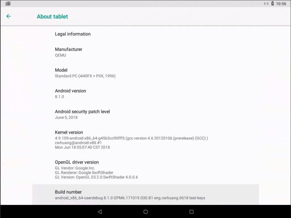

November 17, 20187 yr I got it working without any VMDK conversion on libvirt using QEMU 2.12 and q35/i440FX chipsets. Since the android 8.1 x64 rc2 is built with kernel 4.18, I decided to pass in a physical Nvidia GPU, GTX 970, this works for a little bit then the VM just freezes completely or reboots. It would be nice to have this working with hardware decoding support, could serve as a very nice media player.
