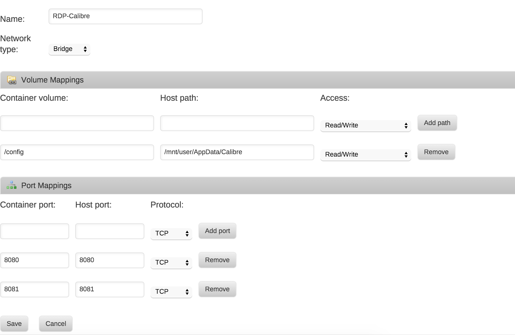

I am having an issue with the plex requests docker. Everything appears to pull and install correctly, docker reports that the container is started. But when I attempt to browse to the service, it gives me a "Connection refused".  I can't seem to find any logs, so I am not sure how to troubleshoot it at this point.
Here is a screenshot of my configuration:

Change the configuration folder location to either a cache drive or if you don't have one, a disk location.
/mnt/cache/blah
/mnt/diskX/blah

I deleted the container and image, added it fresh and changed /config to point to /mnt/cache/appdata/plexrequests
I am still seeing the same issue

Can you post a log?
Also, how long did you wait? At container start, it updates meteor and a couple of times I noticed the meteor servers being ridiculously slow. It took 20 minutes for the update

After 45 minutes, the docker started responding. It looks like the meteor servers were just really bogged down. Thanks for the help, and for the awesome docker containers!

Aptalca, I am having a problem with Calibre.  I believe I have installed everything they way I'm supposed to.  Please see my attached screenshot.  When I first logged into Calibre it had me do some set-up steps.  It asked me where to save my library.  I had to create the "calibre" folder in root (/calibre) to match what I had set-up in the Unraid GUI.  So everything is running.  However, Calibre comes with one book already in the database (the Quick Start Guide).  I look in my /mnt/user/AppData/Calibre/config folder and there is no book there.
How do I add books to calibre.  Through the webgui it lets me choose a folder where the books are that I want to add.  Yet, I can't get to any Unraid shares, just local files in the container.  I really think I'm missing something and I don't know what it is.
Nevermind!  I figured it out.  I needed to put the books into the /config folder not create a /calibre folder.
Thanks
