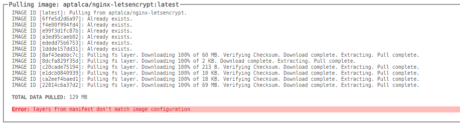

Sorry if this has been answered, I did find a mention this error but it sounded like a problem with the Docker container? When I attempt to update my nginx + let's encrypt docker I get:-
"Error: layers from manifest don't match image configuration"
Do I copy off my config somewhere, make a note of the settings and delete / re-download? If. do that will it need to regenerate the certificates again? Currently got t sitting behind an OpenVPN docker which intercepts all 443 traffic. I can get that out of the way I guess for a new setup...
You have to delete your docker image. Read the FAQ stickied here
Your config is safe, its only the containers that live in the docker image.

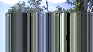

I have a question about my ZoneMinder 1.29 docker.
When i use ZoneMinder 1.29 in docker, i have a incomplete frame 2-6 time a day.
I'm testing with my ZM 1.29 Docker and ZM 1.29 in a VM on the same UNRaid server. Always use the same stream of my 2 cameras.
I have this incomplete frame only on my ZM docker and not on my ZM VM.
Is it possible to be a resource problem with docker?
Thanks for your help.
Could be. I really can't say. The container uses the same settings and resource allocation methods described in the official install guides, but being run in docker could have side effects. I'm afraid there isn't much to go on.

I am getting this error when I try to update/install Let's Encrypt:
Any suggestions? Thank you.
Look in the Docker FAQ sticky for that error
