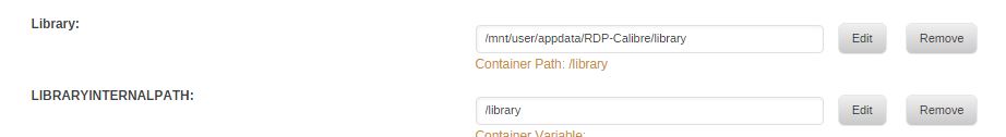

I just set up the RDP-Calibre docker, and was able to get a preexisting library mapped into it. When I open the WebUI, I see all my books and it's great. I'm not exactly sure how to make the library available outside the docker, though. I enabled the web server under preferences in Calibre and set the server port to 13579, added a username/password, and I've mapped docker port 8081 to 13579. When I go to saidin:13579, I get prompted for a username/password, and once I enter it, I end up at the normal web interface where you can view the library and download books. However, when I click on either "Newest" or "All Books", I get the error below. If I click on "Random Book" I get a 404 page saying this library has no books. How do I make my library available outside the docker?

Don't enable the server in the gui. There is already a separate server instance running at the other port. You probably didn't set the library path variable in the container settings. It's described on the docker hub page.
Is this what you're referring to? The "library" entry is the location of my preconfigured Calibre library, and LIBRARYINTERNALPATH is the variable I got from your post here.
I just deleted and recreated the docker twice, and had the same issue both times. The first time I added in a preconfigured library as in the screenshot above, the second time I created a new library. Both custom and new library give the same error pages as I described earlier.
Well I just fixed it... it really helps if you read the setup instructions completely. Ugh. I missed the line that said "set your library to config on first run." Once I did that, I was able to add the environment variable and map it to my existing library just fine. All my books are showing up in the docker and are being served out over 13579 just fine.
