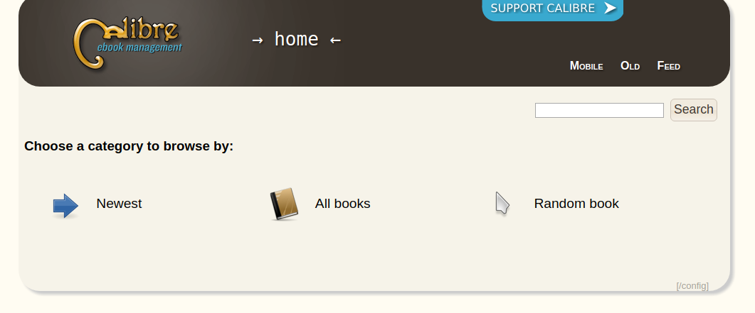

Hi! I'm having an internal debate that is getting stuck at the moment.  I'm using the calibre rdp dockers with the content server enabled.
It's working great but I have one problem in that my kobo's Web browser can't handle the built in authentication that calibre uses.
Additionally,  I'm using the linuxserver version of letsencrypt to access the content server, but again the same kobo browser can't handle the basic auth.
So I'm wondering,  will I be opening myself up to significant risk by having the content server running at https://books.domain.com running without auth? I just don't know about the risks when it comes to a docker like this.
As further info, I've also run ubooquity with auth successfully on kobo, but want to switch to calibre because ubooquity often can't transfer book files to the kobo. I'd switch to kindle but the rest of the family all have kobos now too. Sigh..
Thanks!
