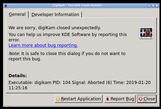

I'm can't seem to get the DigiKam to work.  Installed with these settings:
Container port 8080 ==> 9555
Container path /pictures ==> /mnt/user/pictures/
edge is 0
container installs, but the log has errors.
digikam-install.zip
open the webui, go through the first setup wizard.  I keep the default settings, except setting the image library to /pictures
The wizard finishes, but after 10-15 seconds it crashes.
digikam-webui.zip
Any ideas what's going on?
