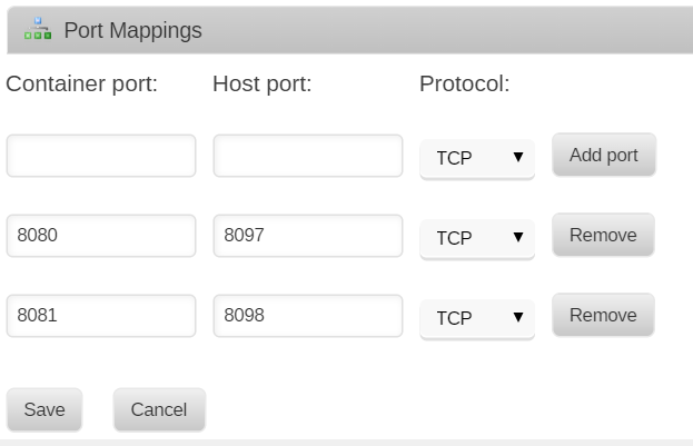

OK...I'm sorry.  I consider myself a moderately intelligent guy but I am totally struggling with a strategy for Calibre.
1.  Do I still need both the Server and RDP containers.
2.  How can I avoid port conflicts?  My Kodi-Headless is using 8080.  How do I address?
Here are my mappings:
TIA!

No problem
The calibre-RDP includes the calibre server, so no need to install both
In your screenshot, the ports listed on the left are internal to the containers (container port). The ones on the right are the ones exposed by your unraid server (host port). Your kodi is exposing port 8080 in both the container and unraid, that's fine. When unraid receives a request at port 8080, it forwards it to port 8080 in the kodi container.
When you install calibre-rdp, set the two host ports to whatever you like, whatever is not being used by other docker as in the attached screenshot. You can then access the calibre server by going to unraidIP:8098 and you can access the calibre-rdp by going to unraidIP:8097/#/client/c/Calibre
That way when unraid gets a request at port 8098, it will connect it to port 8081 of the calibre-rdp container, which is the calibre server
