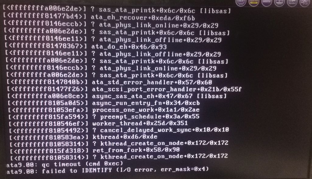

Hello Fine people,
I just got in my new SUPERMICRO AOC-SAS2LP-MV8 and loaded up my Unraid 6.0-beta15 and got the (see attachment) error. From what i think i recall, the bios on the card is 4.0.0.1812. I was wondering if anyone else has experienced this issue? If i disconnect the AOC-SAS2LP-MV8 from my SAS expander the error goes away. During post, the new card does see all the drives attached through the expander, but once it goes pas the unraid default menu and quite a few scrolling pages later i get the error message.
Is anyone else having this issue, or have an idea as to what i can try?
Thanks!
Has anyone at all seen this error, or can suggest something to try?
I'd say a bad card or a bad driver.  Update the firmware if possible.  Will it work with only one drive attached?  Perhaps there is a bad port.  If one drive works, move it to each port and test again.
