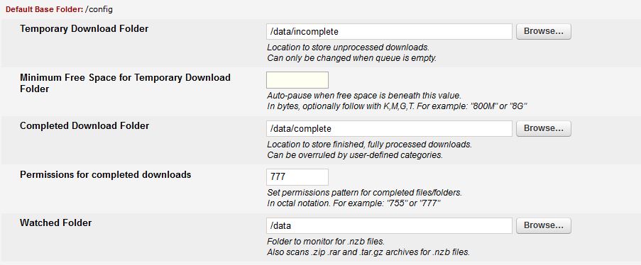

Hello,
I have newly installed the v.6 and started using Dockers.
Sabnzbd works well if directly fed a nzb file in the watched directory.
But when fed by Sickrage the data is not processed (uncompressed, moved) after download.
The download is successful though.
I can see that Sabnzbd is trying to post-process into a folder I didn't assign, but I don't know why.
Please see the attached captures.
I don't use Sickrage but it's possible that Sickrage tells Sab where to put the downloaded file via the API. Post the volume mapping of the Sickrage docker and the post processing settings in Sickrage.
Overall, the basic error is caused because the SAB docker has no idea where /mnt/user/Media directory is.
Also, it's pointless to have /complete and /incomplete volume mapping. You have /data mapped to the directory above those so use /data/complete and /data/incomplete inside the docker, just like you did.
