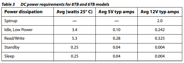

These new disks are reportedly shingled as well, platter count is in Seagate's specs, rpm are not specified, but if they really are 2TB/platter it has to be lower than 5400rpm to only have the same performance as the old 1.33TB/platter drives.
http://www.seagate.com/www-content/product-content/barracuda-fam/barracuda-new/en-us/docs/100805918d.pdf
Very interesting.   The specs also show a max sustained transfer rate of 190MB/s -- the same as the archive drives.   Doesn't make sense with the higher density platters unless they are indeed spinning appreciably slower to achieve the higher platter density.    But the drive is shown as a 7200rpm drive (at least in Amazon's listing for it):

7200 rpm they are not for sure, I suspect they are around 5000rpm, it's the only way the performance makes sense, they also use very little power, also consistent with low/lower rpm:
Agree -- I was just noting that the performance is not consistent with the specs noted on Amazon & Newegg's listings for that model.    I suspect the model # for the drives in the external cases is, for some reason, not correct (or perhaps there's both a "Pro" and a non-Pro version with the same #)

ST8000DM004 / ST8000VN0002:
Maximum sustained data transfer rate - 190MB/s / 230MB/s
Number of disks/heads - 4/8 - 6/12
Idle power - 3.4w / 7.6w
Agree with johnnie => the disk are VERY different.    The most perplexing thing about the performance of the DM004 is that it's so much slower than the previous version even though they're significantly improved the areal density of the platters.   This almost certainly means they're simply running them at a much lower rpm ... which is also supported by the very low power consumption figures.
