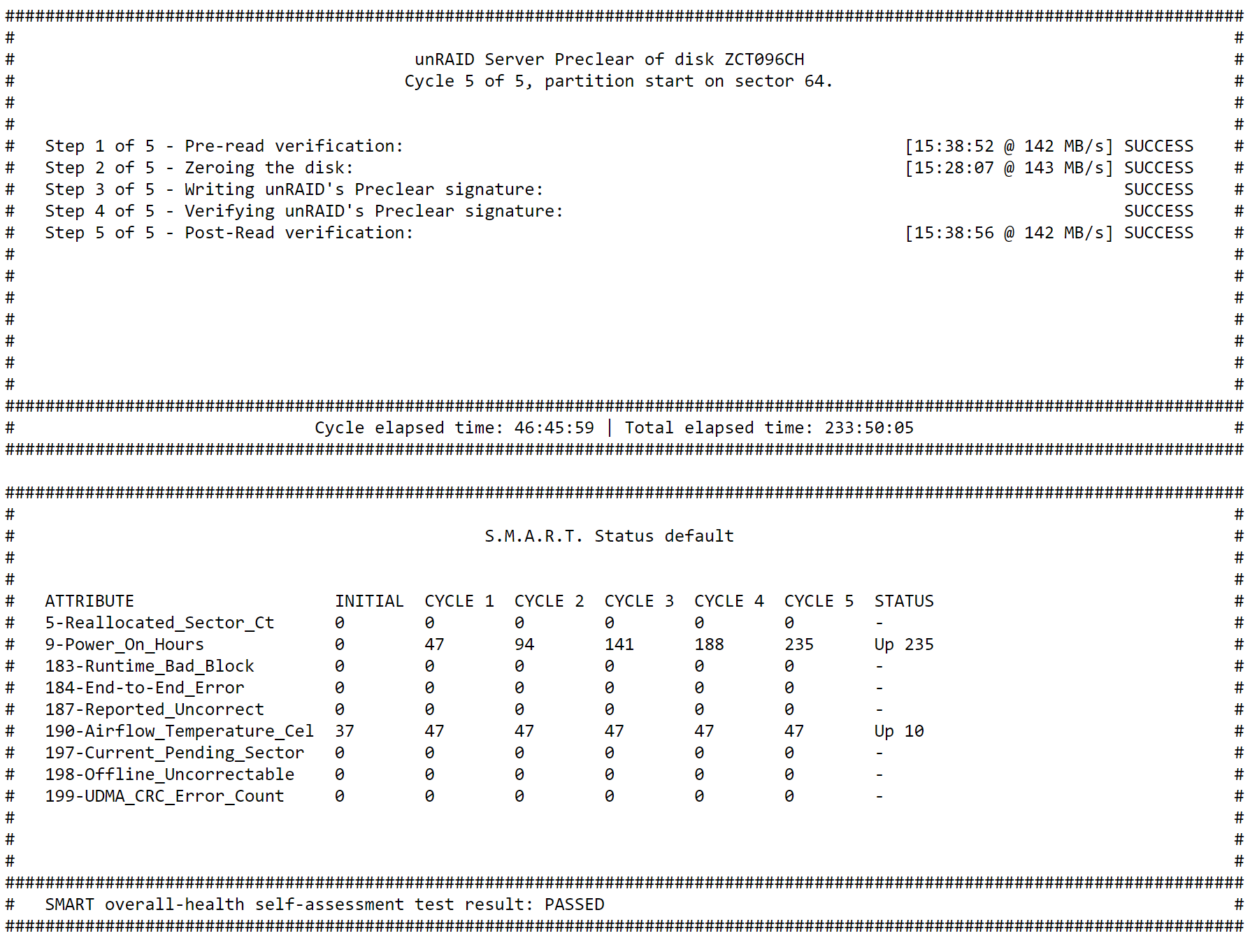

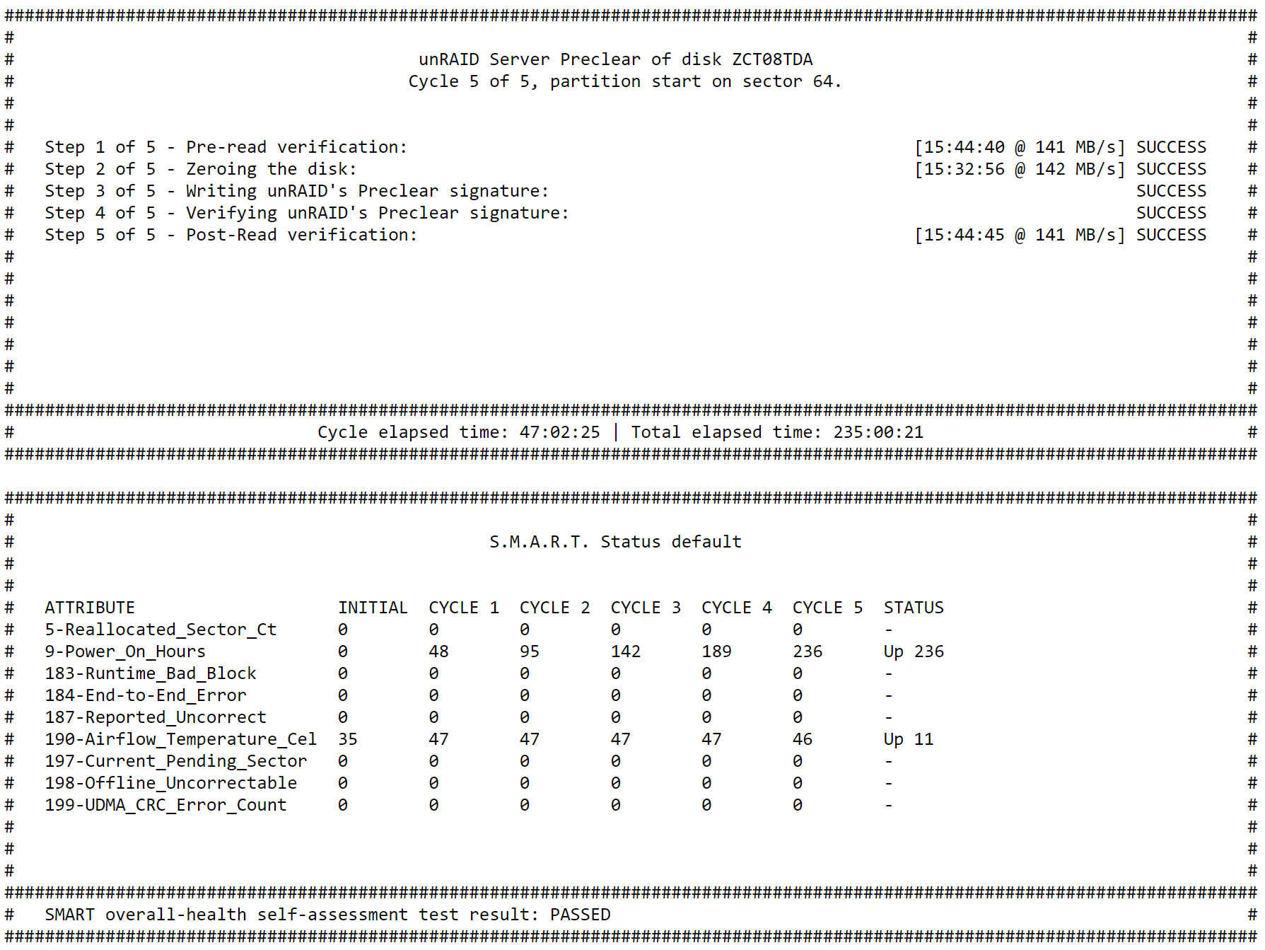

I bought two 8TB Backup Plus' from Costco a few weeks ago. I did a x5 pre-clear on them. I thought I'd share my results for all to see!
2018-11-28 18_28_12-https___69e207e2e6b30c66d8210aa4ce79c4b148b49103.unraid.net_boot_preclear_report.png
2018-11-28 18_28_41-https___69e207e2e6b30c66d8210aa4ce79c4b148b49103.unraid.net_boot_preclear_report.png
I have close to 20 of these drives amongst my servers, just bought two more, love them and they work no problems.
47*C on the drives. I never understand why my drives run so much cooler. Even under load, if mine hi 28*C it'd be a stretch. They idle at 20C

17 hours ago, eagle470 said:
I precleared them inside the cases
which explains the temperatures are higher than @jpotrz was expecting to see.
Five pre-clear passes though! That's 5 x 3 x 8 = 120 TB of reads/writes, which is more than twice the annual workload in less than 10 days. That's my main objection to these Barracuda Compute drives - they have a very low annual workload rating (55 TB/year) which, on drives of such capacity, you'll exceed just doing a monthly parity check. However, in their favour, they do have an unrecoverable read error rating of one per 10^15 bits read, which is an order of magnitude better than a WD Red.

Yeah, my basement is small, so it doesn't stay very cool, even when it's below freezing out.
I figured if they were going to burn out, it would be then. I bought some Samsung 5TB externals for 105 a few years ago and had 1 fail (seagate inside), didn't want a repeat of that (i had shucked before pre-clearing because I was new to this.)
