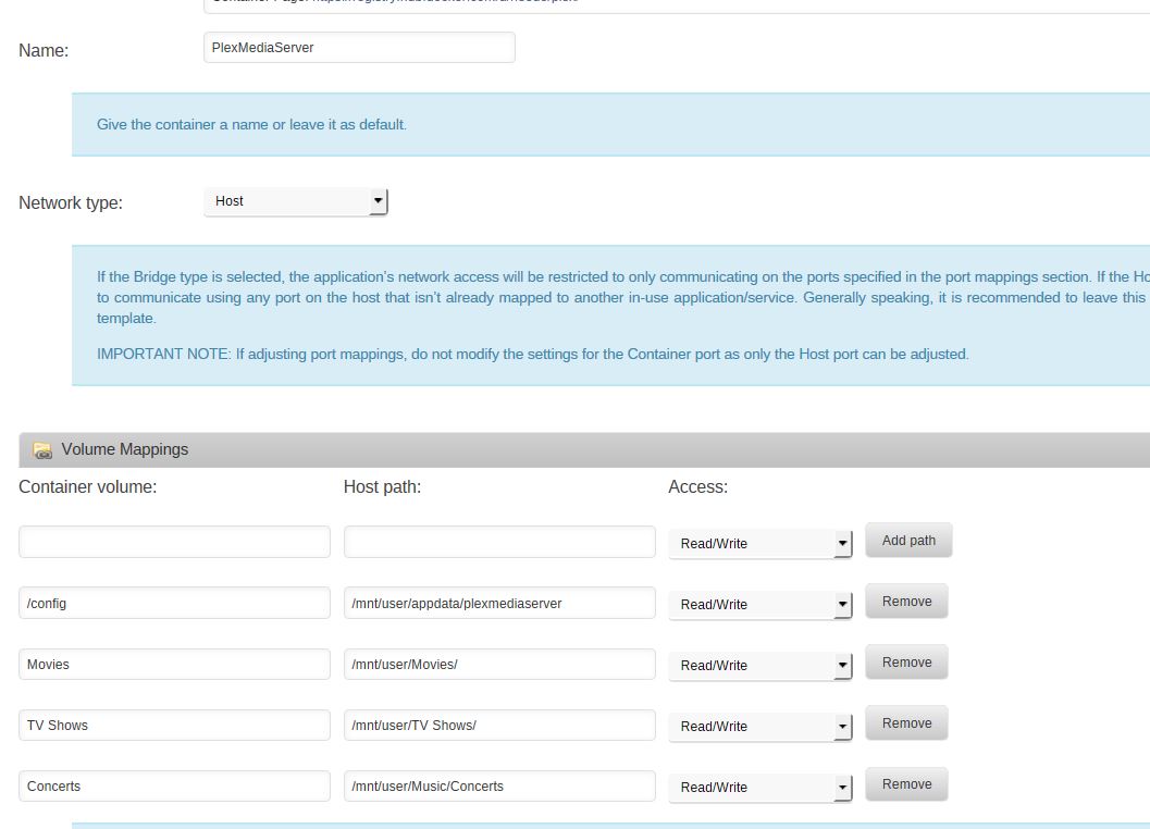

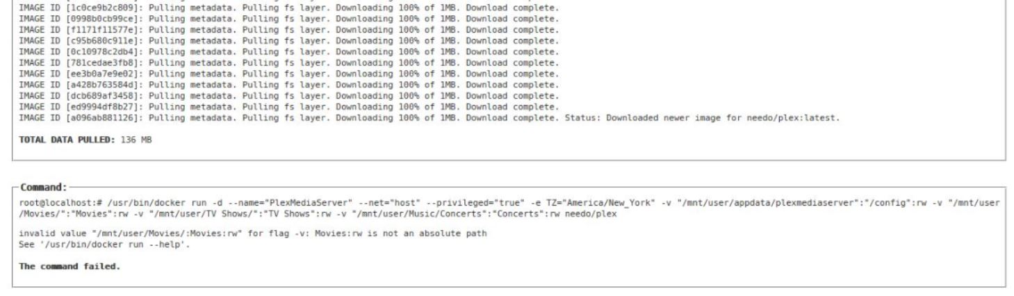

I took a first stab at creating a Docker container for my Plex library, and after about 15 minutes it gave a failure message (please see attachment).  When I went to the Docker tab, it had created a template called My-PlexMediaServer where it had saved my mappings (screenshot attached).  I set up the appdata share on a 250GB SSD to use chache only.  I know I'm pretty close, can anyone please tell me what I'm doing wrong? Thanks!
Try putting a slash in front of movies, tv shows etc on the container paths
Thanks Squid, that worked!!
