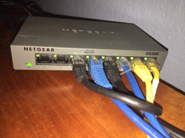

The funny thing is that I do have a Megabit switch (see photo) connected to the Zyxel poweriine adapter, and where both sending and receiving devices connect, along with a few more.  I have no idea what's going on; I'll keep trying different things. It's not the end of the world, but it is quite puzzling.  Thanks for your help!
GBit ethernet can be very sensitive to cabling issues. Try plugging things in again or switching cables.
