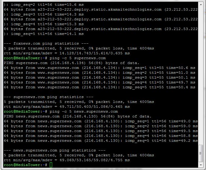

When I had it at my house, everything worked fine.  When I moved it to his house (his network) all of the apps stopped resolving DNS.  In Network config, with everything set to Auto, there is internet connectivity and I can ping out from the Tower to IP's but not hostnames and the apps can access the internet if I replace URL's with IP's.  If I manually set DNS to 8.8.8.8 then I can ping hostnames from command prompt, but the docker apps still cannot resolve any DNS.  Not sure what to do here.  Any help appreciated.

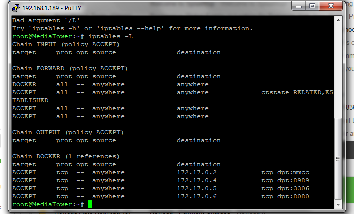

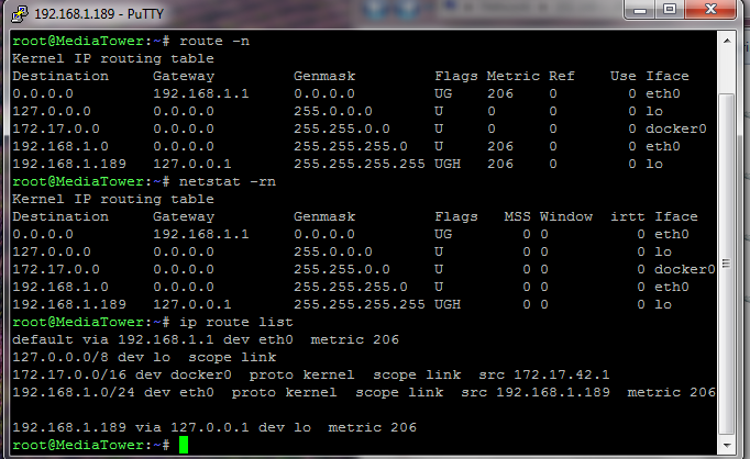

I tried specifying the gateway (router) as DNS server, the ISP DNS servers the router uses as well as 8.8.8.8, 8.8.4.4 and none of the above resolved the issue.
Can pull down additional dockers from the WebGui, the Dockers themselves appear to be unable to resolve DNS.
Changed docker connection to host, updated config, then back to bridge and it fixed it.
