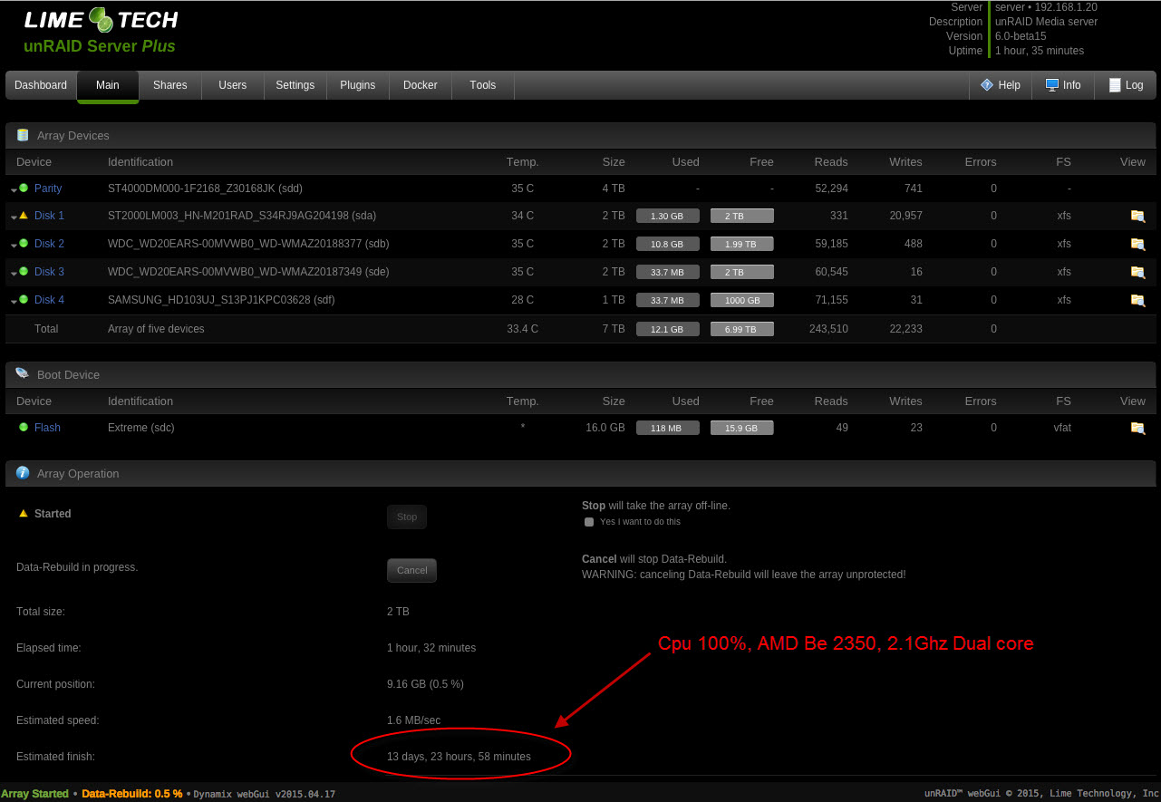

Building a new unRAID server and after some read errors from a WD green i replaced the disk with a 2TB Samsung 5400rpm 2,5".
The complete array only have 1 movie in it, 1,3Gb otherwise it is free from files.
But the rebuild estimated finish is like 14 days!!  I thought my 8 year old Drobo was slow with 70 hours to rebuild.
As you can se in picture the CPU is an AMD BE 2350 with 2,1Ghz and dual core and it is running at 100%.
And if i try to watch the movie through smb it stutters and lagging ofcourse.
Seems strange that the unRAID server would be useless for up to 14 days while rebuilding.
Is is supposed to be this slow to rebuild? Or will it be faster, or am i missing something?
Thanks for your support.

The replaced WD Green drive had read errors and failed the Smart tests. I also had an used ssd drive as cache that stopped working.
All other disks was ok on smart test. Before I putted it all together again i ran Wdidle3 and disabled "intellidrive" feature on the 2 WD Green that i have in array.
The good part is that i do not have any data to loose in array, the bad part about this error is that i really want to sort this out so i can trust unRAID. I can ofcourse clear all data and start over the parity but then it feels like i give up and do not learn anything about this.
Syslog attached and it says something about an bus error that i don't understand.
