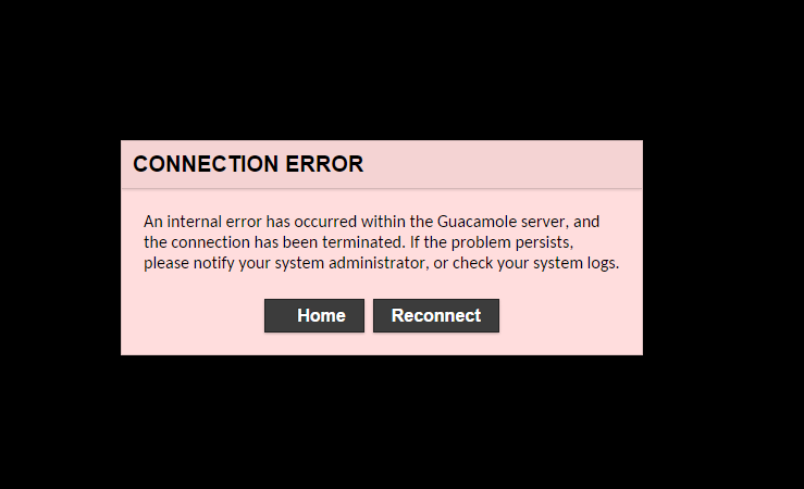

I got further, browser cache issue, but now i get "internal error as occured withing the guacamole server...."
Also, a suggestion: The webui link on the docker icon/menu doesnt change, the port used stay at 8080 while i change to something else when start the docker. Would be great to have it the same as the configured port.
the port mappings work fine..
if you're changing the container port however, things won't work, change the host side only.
Would you know why I keep getting this when opening the webui ? See attached image.
Logs are also attached.

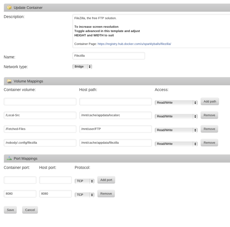

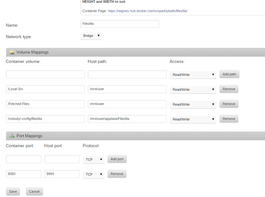

take a screenie of the docker template screen (the screen used for adding the docker) , click on the docker icon and select edit to reach it.
here you go the screen shot.
Just not sure. nothing too fancy about my unraid server I must admit.
