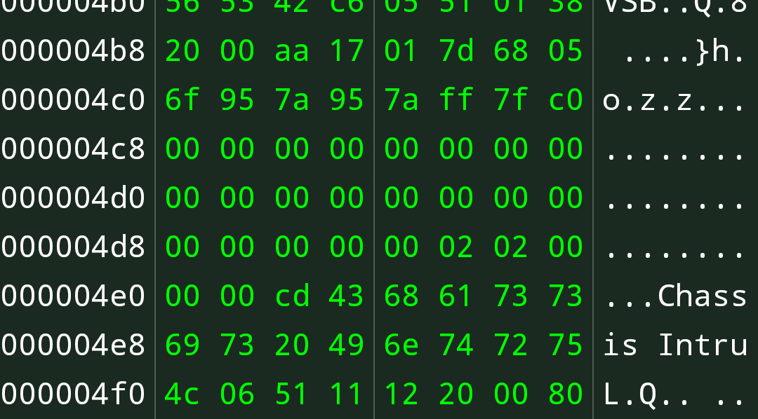

i have one question, can i get turn off chassis intrusion detection, something in this plugin i can set to ignore it.
Does it show up as a sensor? If so, could you post the results of ipmitool sdr elist or ipmitool sdr dump sdr.txt. The later will produce a binary file that you should be able to post.

Chassis Intru    | AAh | ok  | 23.1 | General Chassis intrusion
Could you try this command
ipmitool raw 0x30 0x03
no output and no change in the webui page.
http://www.supermicro.com/support/faqs/faq.cfm?faq=10307
was it supposed to return a reservation code or something akin to that post i linked.
It was supposed reset the chassis intrusion like here
http://www.supermicro.com/Aplus/support/faqs/faq.cfm?faq=11894
But I was looking at the link you posted too. You could try disabling it if that's what you wanted.
yes please....

I was looking at this link
But I'm not sure what the sensor's record address would be for your board.  I was looking at the sdr.txt with a hex editor and at offset 4b8 there's the info for your chassis sensor but I'm not sure if the 01 immediately following the 17 is what you want but maybe their tech support can help.
The aa is the address from ipmitool sdr elist.
yes please....
just fired off email to them, thank you for your assistance, and once again thanks for the plugin.
