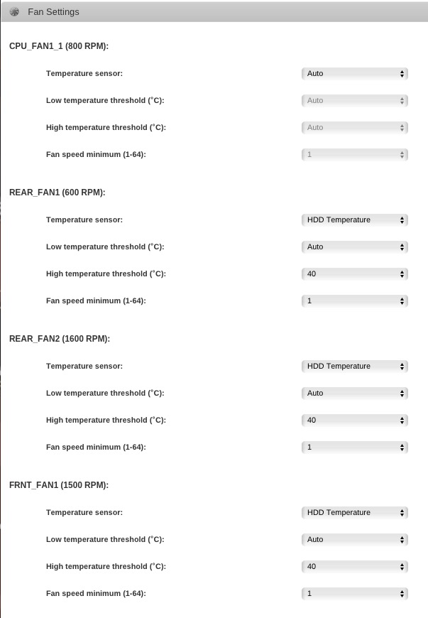

That's a nice board! Does the fan log show anything? What are the names of your fans when you run ipmisensors? Are your fans 4 Pin PWM fans? On the Readings page what browser are you using? If using Chrome or Firefox can you check for browser errors?
Here's a screenshot of my fan settings.

Something with the javascript isn't working. Your Advanced View switch isn't showing up so there's an error somewhere. What browser are you using?
safari and Firefox i checked on both, and OK after delate config and reinstall FAN settings back.
