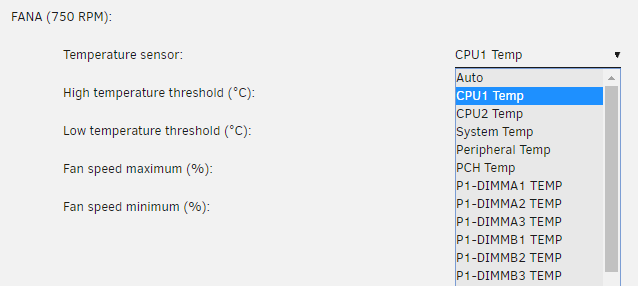

I've read this like 4 times now... Thanks, that is VERY helpful.
SO... if I read you correctly. I could:
Use one zone (FANA/B) to run CPU fans - basing the controls and thresholds on the CPU temp sensors
Also use another zone (FAN1234) - referencing the highest HD temp to control case fans
That... sounds... AWESOME
I'm just so nervous to mess this up and cause a meltdown. Part of my trepidation is I'm running e5-2690v2 procs which are 130w TDP ... I'm actually on round 2 of Noctua coolers (NH-D9DX i4 3U). I'm worried they won't keep pace under load. In my limited testing it appears I'm getting some level of thermal throttling under load presently with fans at 77%. However, they don't seem to ramp to 100% unless I set it that way in the BMC. This is all with the standard fan control in BMC, not through the plugin.
It's not likely that I'll hit such high sustained loads regularly, but I also want to build it so that I don't have to ever worry about it. Do you think it's best to manage fans via the BMC or the IPMI plugin?

@CowboyRedBeard I would probably switch up my fans. I would have cpu and case fans on the numbered fans. And cool the hard drives with a & b. If you have your cpu fans at 100 but the case fans are running slow there would be a build up of heat inside your case. Same could be said for the hdds. It all depends on how your case is set up. But with the plugin you have a little more control. I would find out what temp your cpus are throttling at and set the fans to max at that temp or a little sooner.
Hrmm... so just now messing with this again. I guess the issue I have is that FANA/B for CPUs based on CPU temp is based on the temp of just 1 CPU...
So if I ended up having 1 CPU get really hot, and that wasn't the one being monitored... then that could be a real issue.... I guess I could do one zone for 1 CPU and the other zone for the other CPU... but then that would leave the drive & case fans to be done via my dedicated controller... Which is what I have today. So maybe I'm to let SM BMC control the CPU fans, my dedicated controller to case & drive fans (it does have a probe) ... and I just use the IPMI plugin for monitoring and alerting.
Thoughts?
Edited by CowboyRedBeard
Thoughts?
Only thing I could do is possibly add multiple or secondary temp sensors and choose the highest temp from them.
I think this would be a useful addition for people who want to tie the case fans to HDD temps and the CPU fan to CPU temps. If the CPU is being worked and gets hot but the HDDs aren't, the case fans could spin faster based on CPU temp to evacuate the heat based.

Question 1) I was wondering, is there any disadvantage of having a lower temperature polling time value? 3 minutes seems kinda slow, if my CPU is idle and suddenly has a big encoding workload I definitely don't want it to wait 3 minutes until the fans adjust. I was thinking of 30 seconds.
Question 2) If I manually set up speeds according to CPU temperatures, does it completely ignore HDD temperatures?
Question 3) Any performance disadvantage of using the plugin instead of whatever the BIOS/BMC would do by itself? As in, is there a dedicated chip on the motherboard that would usually do that instead of using CPU resources (assuming your plugin does in fact use the CPU to poll the temperatures).
Edited by dnLL
All right well I changed my non-PWM S12b for a F12 (can't go wrong staying with Noctua) and it works (and it's also a huge improvement, I have an ITX case with restricted airflow).
1) 30s or 1 min is probably fine but constant polling of bmc and hard drives can affect performance adversely.
2) Yes. It will only take in to account the temp sensor you set to monitor. If you just wanted to control CPU fans based CPU temps, you'd be better off letting the BIOS smartfan/BMC control the fans. Unless you wanted to have more control than smartfan allows. Like min/max fan speeds.
3) The fan control script shouldn't really present and performance issues. It doesn't use much CPU and only 150-200 MB of memory of I remember correctly.
The original intent of the fan control was to allow controlling a fan based on hard drive temps. Using the BIOS smartfan temp control only took into account CPU or system temps. So for me, during a parity check or rebuild the CPU temps wouldn't go high enough to make the fans spin fast enough to cool the hard drives.
I'd need to take a look at the BIOS options again but last time I checked only the CPU fan would go faster according to CPU temps, not the chassis fans. The issue I have is I need to reboot to get to the BIOS in the first place, whereas with a software plugin such as yours I can edit settings on the fly.
I just checked and everything I need is in the BIOS so I'll go with the SmartFan options (with a more agressive profile than default). Can't say the BIOS is the most user friendly but it works. I'll keep an even more aggressive version of the settings within the plugin so that I can enable it if I'm doing anything crazy.

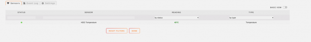

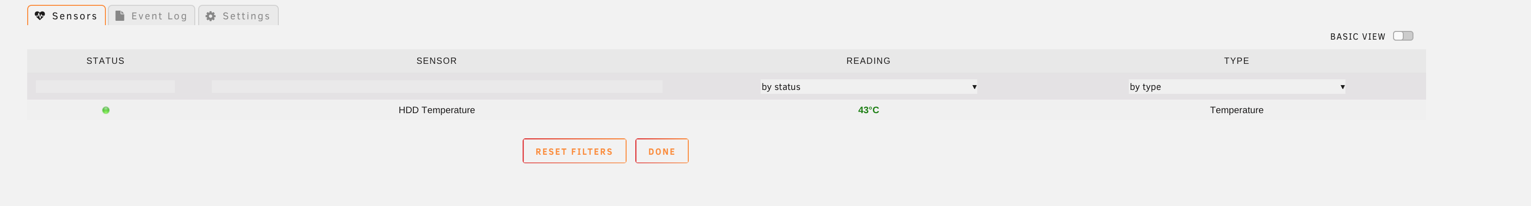

I have an intel s2600CP board with 7 fan headers.  I have disabled all but header 4.  The IMPI tool sees fan header 4 and shows the fan spinning at 8400RPM.  It sounds like a jet.  How can I lower the fan speed or base the fan speed on a temp reading?
Anyone know why I am getting this error?  Also see below screen showing only one temp sensor.  I ran a command that wiped out all the sensors.  How can I get them back?
ipmitool -c sdr
SDRR successfully erased
Err in cmd get sensor sdr info
Get SDR 0000 command failed: Requested sensor, data, or record not found
