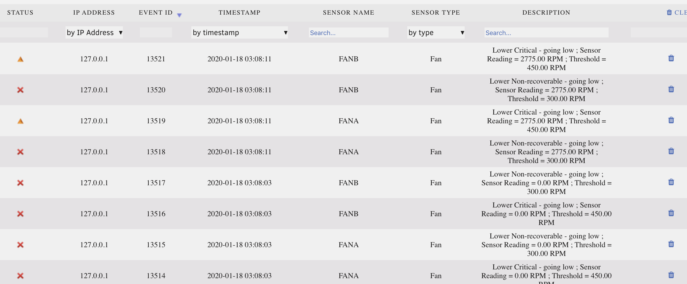

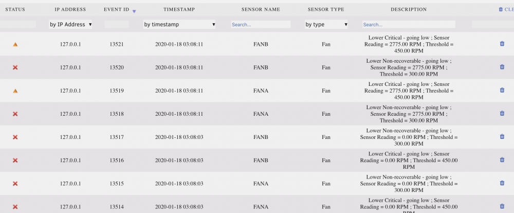

So I think I have it working with my X9 board. Apparently it won't work except through localhost for me.
But lots of errors related to FANA and FANB which are two mid-chassis fans. FAN1 and FAN2 are the two CPU fans...
Really I want to slow down the 80mm in back which are crazy loud.
