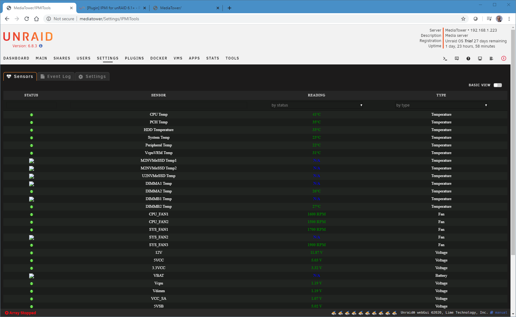

If I look at my Readings page tho, you can see the results in the image.

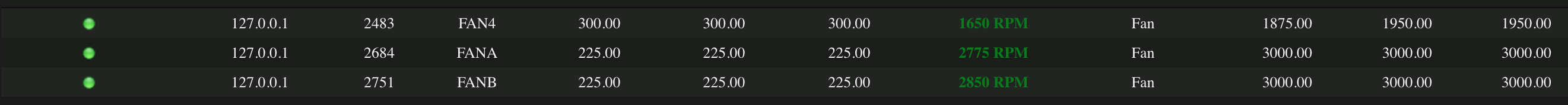

	## Give valid input for sensor type = Fan; units = RPM
	Lower_Non_Critical_Threshold                                                225.000000
	Lower_Critical_Threshold                                                    225.000000
	Lower_Non_Recoverable_Threshold                                             225.000000
	Upper_Non_Critical_Threshold                                                3000.000000
	Upper_Critical_Threshold                                                    3000.000000
	Upper_Non_Recoverable_Threshold                                             3000.000000
	## Give valid input for sensor type = Fan; units = RPM; 'None' to not use hysteresis
	Positive_Going_Threshold_Hysteresis                                         75.000000
	Negative_Going_Threshold_Hysteresis                                         75.000000
EndSection

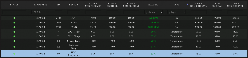

Screenshot above showed I modified the critical thresholds; but the original post said to put all the values between 200 and 300, which I have now done, but still have the same issue:
Again, doesn't matter what I set the minimum fan speed percentage at, when I hit apply, the fans just go to 0 RPM.
Also for reference, this is the relevant section of the config file:
Section 2684_FANA## Possible values: Yes/NoEnable_All_Event_Messages                                                   Yes## Possible values: Yes/NoEnable_Scanning_On_This_Sensor                                              Yes## Possible values: Yes/NoEnable_Assertion_Event_Lower_Critical_Going_Low                             Yes## Possible values: Yes/NoEnable_Assertion_Event_Lower_Non_Recoverable_Going_Low                      Yes## Possible values: Yes/NoEnable_Assertion_Event_Upper_Non_Critical_Going_High                        Yes## Possible values: Yes/NoEnable_Assertion_Event_Upper_Critical_Going_High                            Yes## Possible values: Yes/NoEnable_Assertion_Event_Upper_Non_Recoverable_Going_High                     Yes## Possible values: Yes/NoEnable_Deassertion_Event_Lower_Critical_Going_Low                           Yes## Possible values: Yes/NoEnable_Deassertion_Event_Lower_Non_Recoverable_Going_Low                    Yes## Possible values: Yes/NoEnable_Deassertion_Event_Upper_Non_Critical_Going_High                      Yes## Possible values: Yes/NoEnable_Deassertion_Event_Upper_Critical_Going_High                          Yes## Possible values: Yes/NoEnable_Deassertion_Event_Upper_Non_Recoverable_Going_High                   Yes## Give valid input for sensor type = Fan; units = RPMLower_Non_Critical_Threshold                                                225.000000## Give valid input for sensor type = Fan; units = RPMLower_Critical_Threshold                                                    225.000000## Give valid input for sensor type = Fan; units = RPMLower_Non_Recoverable_Threshold                                             225.000000## Give valid input for sensor type = Fan; units = RPMUpper_Non_Critical_Threshold                                                3000.000000## Give valid input for sensor type = Fan; units = RPMUpper_Critical_Threshold                                                    3000.000000## Give valid input for sensor type = Fan; units = RPMUpper_Non_Recoverable_Threshold                                             3000.000000## Give valid input for sensor type = Fan; units = RPM; 'None' to not use hysteresisPositive_Going_Threshold_Hysteresis                                         75.000000## Give valid input for sensor type = Fan; units = RPM; 'None' to not use hysteresisNegative_Going_Threshold_Hysteresis                                         75.000000EndSectionSection 2751_FANB## Possible values: Yes/NoEnable_All_Event_Messages                                                   Yes## Possible values: Yes/NoEnable_Scanning_On_This_Sensor                                              Yes## Possible values: Yes/NoEnable_Assertion_Event_Lower_Critical_Going_Low                             Yes## Possible values: Yes/NoEnable_Assertion_Event_Lower_Non_Recoverable_Going_Low                      Yes## Possible values: Yes/NoEnable_Assertion_Event_Upper_Non_Critical_Going_High                        Yes## Possible values: Yes/NoEnable_Assertion_Event_Upper_Critical_Going_High                            Yes## Possible values: Yes/NoEnable_Assertion_Event_Upper_Non_Recoverable_Going_High                     Yes## Possible values: Yes/NoEnable_Deassertion_Event_Lower_Critical_Going_Low                           Yes## Possible values: Yes/NoEnable_Deassertion_Event_Lower_Non_Recoverable_Going_Low                    Yes## Possible values: Yes/NoEnable_Deassertion_Event_Upper_Non_Critical_Going_High                      Yes## Possible values: Yes/NoEnable_Deassertion_Event_Upper_Critical_Going_High                          Yes## Possible values: Yes/NoEnable_Deassertion_Event_Upper_Non_Recoverable_Going_High                   Yes## Give valid input for sensor type = Fan; units = RPMLower_Non_Critical_Threshold                                                225.000000## Give valid input for sensor type = Fan; units = RPMLower_Critical_Threshold                                                    225.000000## Give valid input for sensor type = Fan; units = RPMLower_Non_Recoverable_Threshold                                             225.000000## Give valid input for sensor type = Fan; units = RPMUpper_Non_Critical_Threshold                                                3000.000000## Give valid input for sensor type = Fan; units = RPMUpper_Critical_Threshold                                                    3000.000000## Give valid input for sensor type = Fan; units = RPMUpper_Non_Recoverable_Threshold                                             3000.000000## Give valid input for sensor type = Fan; units = RPM; 'None' to not use hysteresisPositive_Going_Threshold_Hysteresis                                         75.000000## Give valid input for sensor type = Fan; units = RPM; 'None' to not use hysteresisNegative_Going_Threshold_Hysteresis                                         75.000000EndSection

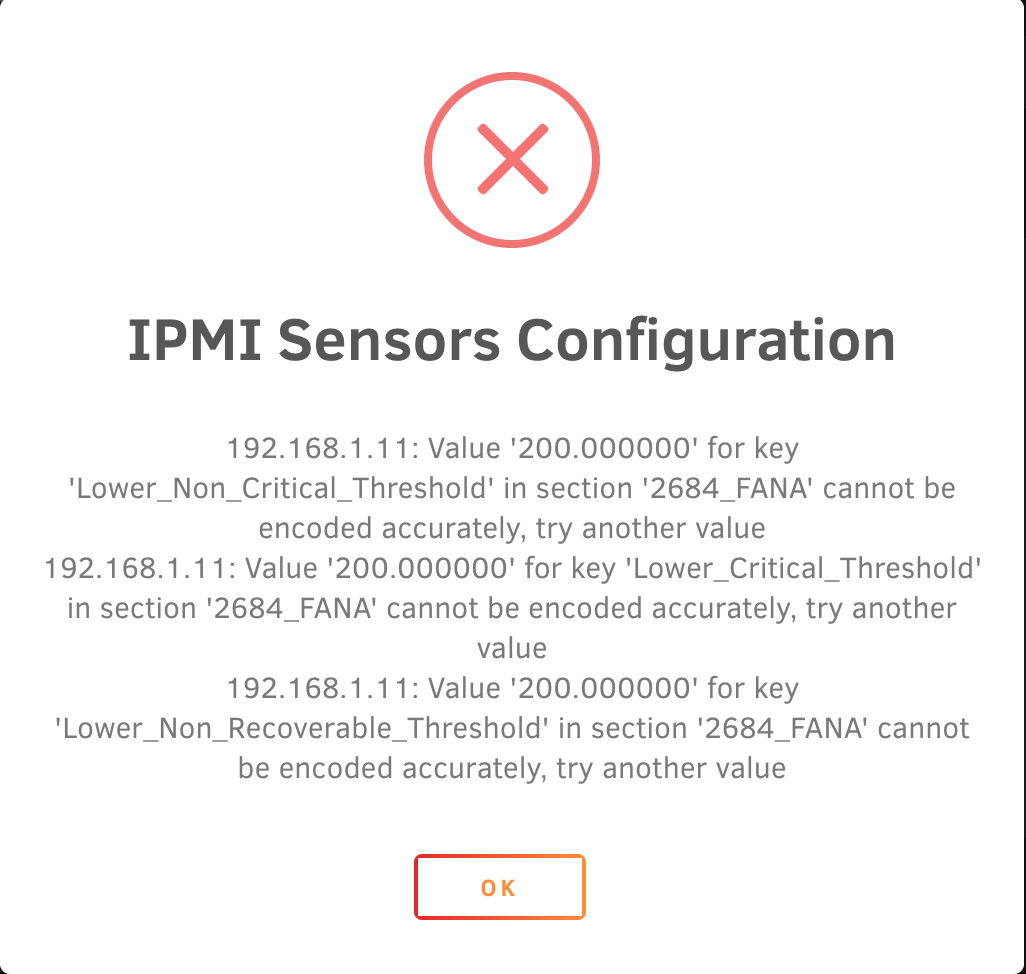

I would try 200 or 300 thresholds instead of 225. I've had trouble with the bmc accepting numbers other than whole hundreds.
Thanks for the reply, for some reason my sensor seems to want multiples of 75, so 200 would not work:
When I set to 300, I still get the same behavior described earlier.  Here is the ipmi log, the log indicates the plugin is trying to do things correctly, but for some reason the fan is just going to 0, then the fan spools up again to 100%

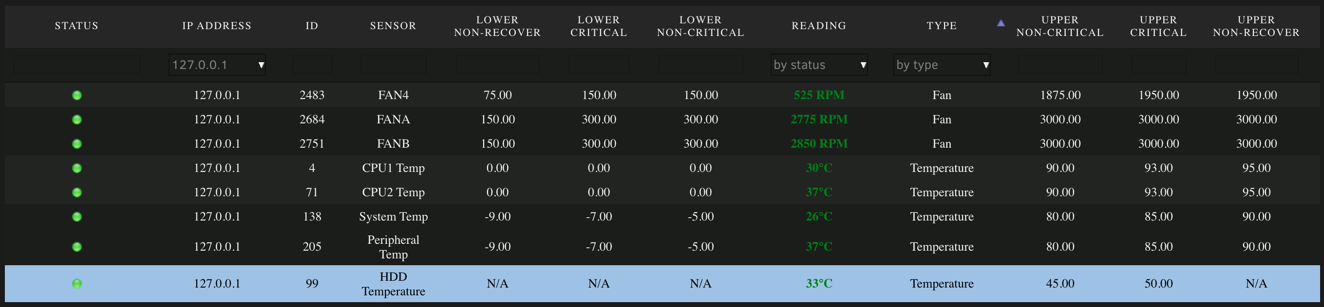

okay, things are weird, I decided to open up the chassis to see what's going on, turns out while the reading reports 0 RPMs, the fans are still actually spinning....so I suppose this is a problem of an incorrect fan speed reading....
muahahahaha I finally got it I think.  What was missing was that I was missing a few sensors from the "Display Settings/Global Available Sensors".  Things started to work when I enabled the two HDD Status snesors (both read N/A) and PCH Temp; I added all those at the same time, so I'm not sure which one specifically did the trick.

Hi
Thanks for a wonderful plugin.  Absolutely great.
Could you help me with lowering the fan speed threshold on the motherboard BMC, please?  I have an X10 board.
The config tab is blank so I'm unable to scroll down to the fans as you suggest above.  Am I doing something wrong or is there a command to type in?
So many thanks
D
I just got my system up and running with my Supermicro X11SCH-F, E-2278G, and Supermicro CSE-836BE16-R920B. Everything is looking good but I've noticed that my CPU fan is stuck at 400 RPM and just isn't responding to any increases in percentage.
I think it has a lot to do with how I currently have things laid out:
FAN1: FAN-0074L4 (on fan wall)
FAN2: FAN-0074L4 (on fan wall)
FAN3: N/A (hopefully will be 3rd 0074L4 that's currently on FANB once I get a extension cable)
FAN4: 2 x FAN-0104L4's (on back of case) that are bound together with a cable splitter
FANA: Noctua NH-9DL with NF-A9 (already lowered the thresholds to 300rpm)
FANB: FAN-0074L4 (on fan wall)
Right now, FAN1234 are tied to HDD Temps and FANA is tied to CPU Temp.
I'm sure I have the CPU fan plugged into the wrong fan slot but I'm open to suggestions on how to configure this.

I installed the plugin.  All the values are either green or blue, except for this one which is yellow:
MB Temp 107°C
That temperature seems really high to me.  Is it accurate?  Should I be concerned and is there anyway to fix it?  Thanks.
