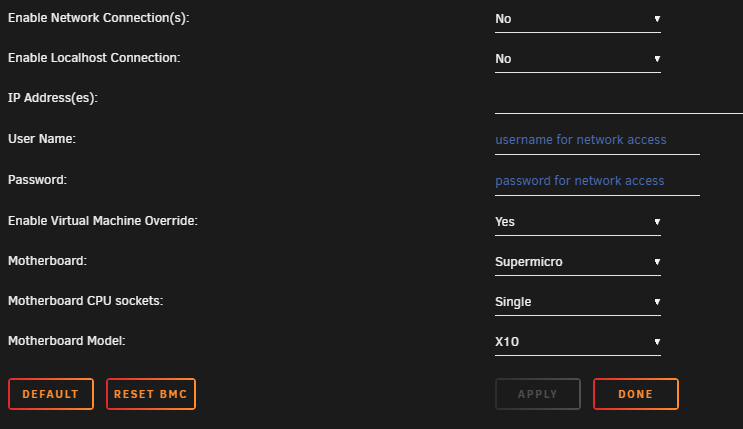

22 hours ago, Froberg said:
Assuming you actually installed the plugin already...
These settings work for me.
That is what I was looking for! For some reason, those settings did not show up right away.  I reset BMC and suddenly they showed up.  Many thanks!

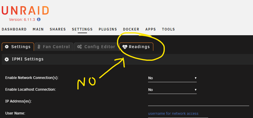

On 12/20/2022 at 2:31 AM, adminmat said:
I've been using this successfully for a X10 Supermicro for years. Just today I noticed all the sensors are missing except for the HDD. And the fan controls have no effect. It all used to work great. Did you find a solution?
never did find a solution 😞
i'm about to change over all my fans, and add a bunch more, so figured i'd just worry about it when i do that lol
So I got the sensors to show and the fan controls working again. Now I can't explain why but I have to leave Enable Network / LocalhostConnections set to No. And leave the IP address username/pw blank. If I enable this is will no longer show my sensors or operate the fan controls. (Maybe I'm misunderstanding what these first 5 setting do)

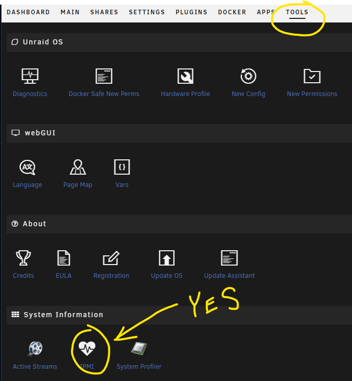

Then, no matter the settings if you click on Readings nothing happens. That tab doesn't open.
You have to go to the Tools tab and at the bottom click on IPMI.

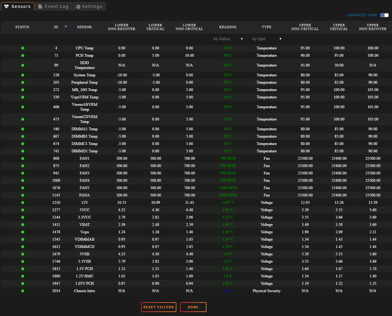

Then it shows all my sensors, fans etc.

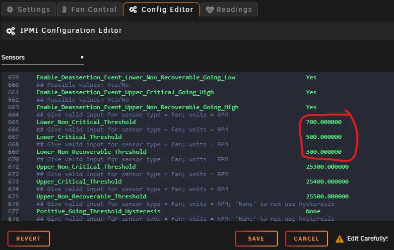

Hope this helps. Now I just need to figure out how to set the thresholds lower. I have to keep my fans (mostly Noctua) at about 700 RPM or Supermicro starts to spool up the fans into panic mode.
Dumb question about configuring thresholds on x10 Supermicro. The developer, Dmacias says to change/lower thresholds in the config editor. If I make these changes is it overriding my BMS settings? Does it permanently change the BMS settings? How to I set it back to default if I break it?
It does override your BMS settings while the plugin is running. If the plugin isn't running your BMS settings will control the fans and IIRC they will default to high speed. I know mine start out on high after a reboot and then change to an appropriate speed once the plugin starts. If you stop or remove the plugin your BMS will resume fan control.
Thanks. So I pulled the FANA fan which was running at 100% no matter what I tried. Not sure if it's due to being a higher speed Noctua fan so I ordered a slower Noctua.
Seems I got it sorted for now. Much quieter. Barely audible.
WoW! had this problem for ages. Thanks a million!

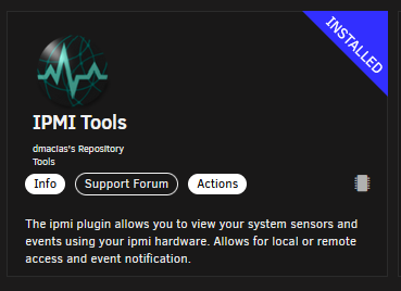

Fix Common Problems is telling me that this plugin is deprecated:
Deprecated plugin ipmi.plg
This plugin has been deprecated and should no longer be used due to the following reason(s): Advised to switch to the version from SimonF which is also compatible with Unraid 6.12+ While this plugin should still be functional, it is no recommended to continue to use it.
Where can I get the new version?  A search on Community Apps for "IPMI" only has two apps for managing Dell server fan speeds.
