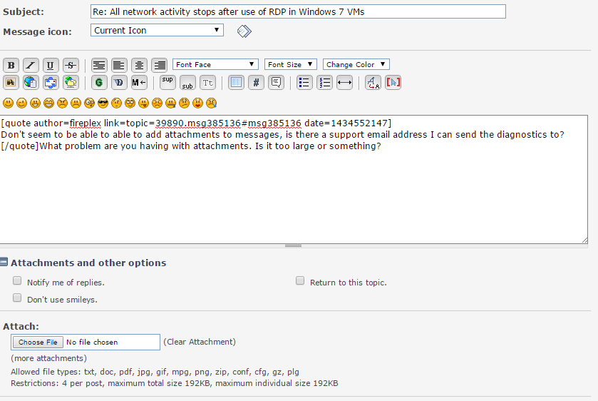

Don't seem to be able to able to add attachments to messages, is there a support email address I can send the diagnostics to?
What problem are you having with attachments. Is it too large or something?
Attachments to messages not forum posts.
Attach to post. That's the usual method for help with diagnosing problems on this forum.
NO, don't fancy doing that so everyone can see, privacy et al.
They must have a support email, or just tell me what's needed and I'll run the commands.
