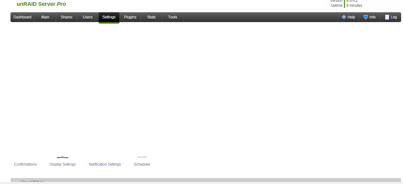

Here is the capture.
From different devices, I was able to see some part of the web ui, but not has it is suppoed to be.

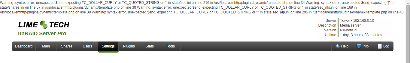

Warning: syntax error, unexpected $end, expecting TC_DOLLAR_CURLY or TC_QUOTED_STRING or '"' in state/sec.ini on line 216
in /usr/local/emhttp/plugins/dynamix/template.php on line 34
Warning: syntax error, unexpected $end, expecting ']' in state/shares.ini on line 67
in /usr/local/emhttp/plugins/dynamix/template.php on line 38
Warning: syntax error, unexpected $end, expecting TC_DOLLAR_CURLY or TC_QUOTED_STRING or '"' in state/sec_nfs.ini on line 169
in /usr/local/emhttp/plugins/dynamix/template.php on line 39
Warning: syntax error, unexpected $end, expecting TC_DOLLAR_CURLY or TC_QUOTED_STRING or '"' in state/sec_afp.ini on line 295
in /usr/local/emhttp/plugins/dynamix/template.php on line 40

The issue is in every tabs. As soon that I Start the array, I miss the top of every tab. So impossible to create Docker containers.
