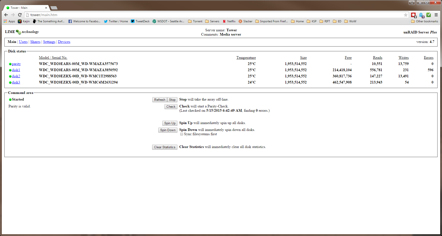

I noticed my unraid box responding slowly to some file access and checked the system log. There were disk errors showing on the original data disk I had purchased. Checking the SMART report shows about 1400 sectors pending relocation, but no actual relocation events yet. Trying a number of offline utilities to get the disk to recognize if it needs to spare them out or not does not necessarily seem to have worked, so it seems it's time to replace the disk, or at least get it offline into another machine to work on as I need to get my unraid array back up.
Please note, even with the read errors in the log, there have been zero write errors noticed by unRaid and the array did not offline itself, nor did the disk red ball. I run automated monthly parity checks and those have all shown zero errors.
I currently have 4 drives attached, all 2TB drives. When purchasing the replacement drive, what I'd like to do is upgrade the parity drive to a larger size (4TB likely), then use the 2TB that was the parity drive to replace the failing disk. I'd hate to spend the money on just buying a replacement 2TB drive when it's just a tiny bit more to open up larger size disks in the future. I also realize that this will require upgrading to the 5.x unRaid to support the larger disks.
What is the best way to make the above changes, assuming that the parity drive is correct, but one of the data drives is suspect?

I had removed the failing disk from the array, started and stopped the array, then readded the disk to force it to rebuild the data on the disk from parity. The rebuild finished without any errors showing up, but after a bit I started to see errors again. I've attached my syslog and the front page of the web UI as requested just to get a second opinion on it. I've already ordered a replacement drive as the drives internal long self-test indicated possible failed sectors, but if there's something else going on as well I'd like to know about it.
Thanks!

Just to save everyone some time, and so we can make sure we fully understand your situation, please go ahead and post both the syslog and smart report for the failing drive, and also a screenshot of the main page.

Trurl,
I've added the syslog and a screenshot of the front page of the webUI as requested. I'm still pretty sure it's the disk itself, but I wanted to get a second opinion.

Added to the opening post.
