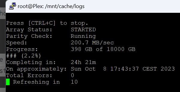

I took the above script as a starting point, added a few things that made its use more useful to me. Disclaimer: I'm no BASH god, and I'm sure it can be improved upon, but for me it does the trick. There are some use remarks in the comments at the top of the script.
#!/bin/bash
# It takes a number of seconds as an argument. That controls how often the script updates.
# To run the script save it to /tmp and set it to execute (chmod +x scriptname)
# then do # "/tmp/syncscript xx" where xx is the refresh time in seconds (without the quotes ;-)
# You can leave this script running while pausing and resuming the parity check from the GUI Main page without issue. :-)
# To stop the script Press [CTRL+C]
# This script will display like this:
# RUNNING
#   Press [CTRL+C] to stop.
#   Array Status:     STARTED
#   Parity Check:     Running
#   Speed:            119.9 MB/sec
#   Progress:         1 GB of 12000 GB
#   # (0.0%)
#   Completing in:    27h 48m
#   On approximately: Sat Sep 16 18:38:31 PDT 2023
#   Total Errors:     0
#    Refreshing in    0

I hope others find it useful.

My GUI stopped responding after starting the array when i replaced the parity disk (14tb) for a new 18tb disk i had no idea what the server was doing..
i selected the 14TB disk as a replacement for a old 4tb disk, i can't format it right now as the gui stopped responding and i had no idea how long it would take..
Now i see this, i think i will have to wait for it to complete... but at least now i know what is happening!
Edited by furian
On 10/7/2023 at 11:30 AM, furian said:
thank you!
Same exact thing is happening to me right now. GUI stopped responding/refusing to connect when replacing 14TB parity disk for a new 18TB disk.
What ended up happening with yours? Did the GUI eventually come back after completion?
