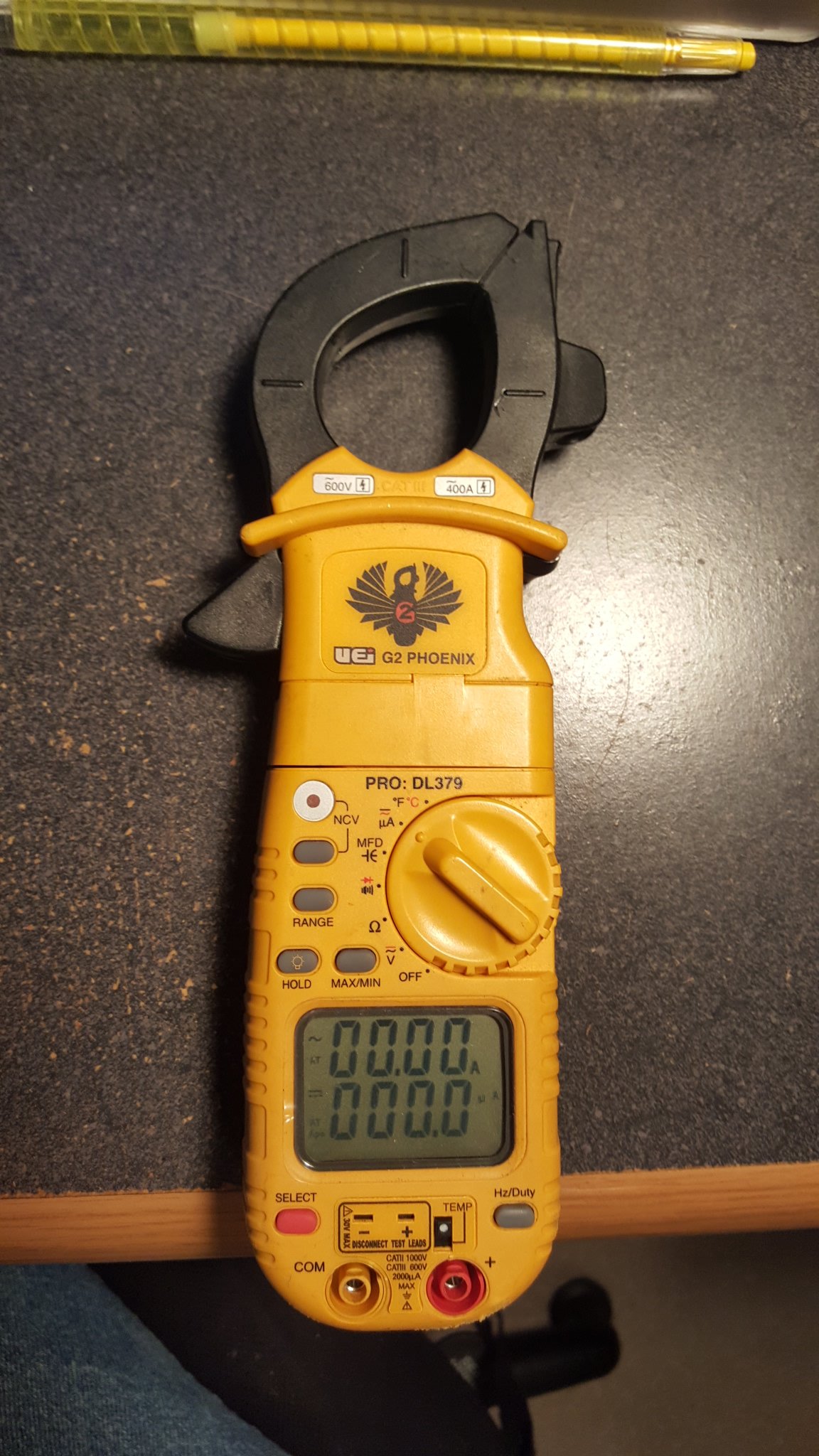

Ok, I don't know what the numbers mean here they are...  First I had to remove the insulation from the three wires on the power cord between the wall and the power supply so I could clamp around either the black or white wires. I have plenty of power cords, so I used my oldest one that I could find.
The meters highest read was .82 amps at power up & .33 amps at shut down. I was watching during the cycle. I tested it three times and these are the highest numbers I saw. Plus the meter has High/Low settings anyway.
Question: is this really .82 amps or 8.2 amps. I left the meter on default which has the decimal two places to the left. There is an option to move the decimal one place to the right (Call Range). The attached photo is of the tool used and it's set to default settings as shown.

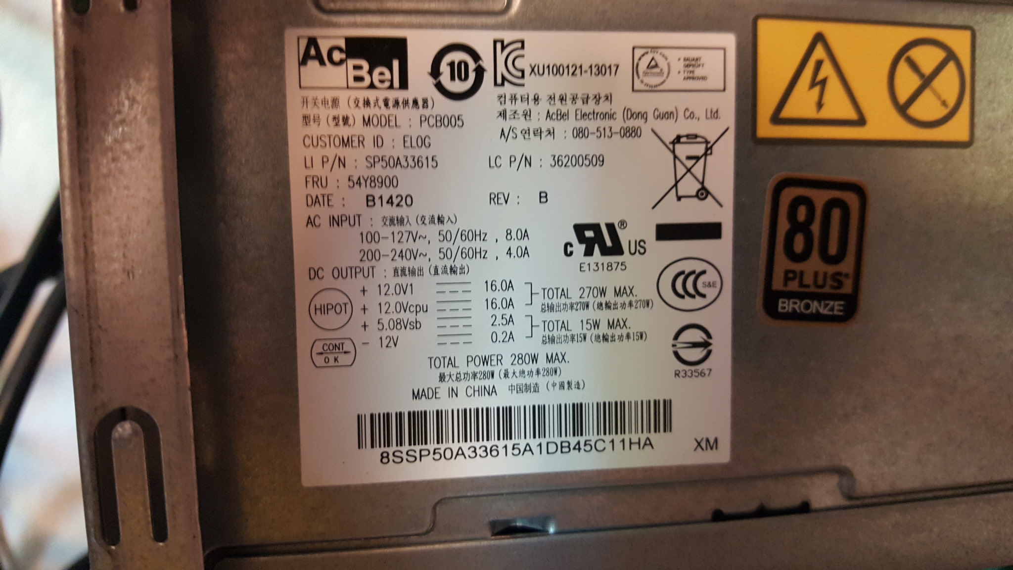

I am leaning that it's 8.2A since the power supply label gives us 100-127V (I went with 120V) and 8A. Which if the online calculator is correct, 960 Watts for a few seconds during startup and 396 Watts during the shutdown. 456 Watts while the server is running. This is the max amount that I saw in my time watching the meter, for a few minutes.
Now which this knowledge (cough...lol) How do I go about calculating how much time I would have with a 500 watt UPS?

If i understand you correctly, skin the power cable from plug to plug. Then loop it around the meter loop 5 to 10 times and report the number plus the voltage read at that time?
The way to count 'loops' is the number of wires in the center when the clamp is closed.  (I.e., when you put the wire through when you made your first measurement that was a 'one loop' coil.  If you would take that wire, wrap around and put it through the center portion again, that is two loops.)  @jonathanm said much the same thing but this concept is rather confusing to most laymen.

Yep, like @Frank1940 explained, you are still only capturing 1 of the 3 wires, either one of the white and black or brown and blue depending on country of origin, just not the green. Open the clamp, and wrap as many turns of that one wire as you can comfortably fit around the clamp, up to 10. Close the clamp fully or unwrap wire until you can, and start logging reported amps. Take the meters face value AMP number, and divide it by the number of wires that actually pass through the clamp. Voltage should be extremely stable, just take a reading at the plug you are using before and after you are done playing to be sure.
Oh, if you want to take a current reading on all three wires one at a time, it could be educational if your house wiring is wrong. The two main conductors should yield identical results, and the green conductor should measure exactly zero at all times. If not, something is wired VERY wrong, and I'd have an electrician inspect it ASAP. :)

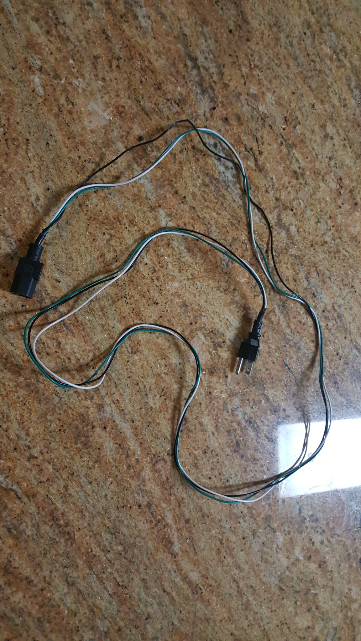

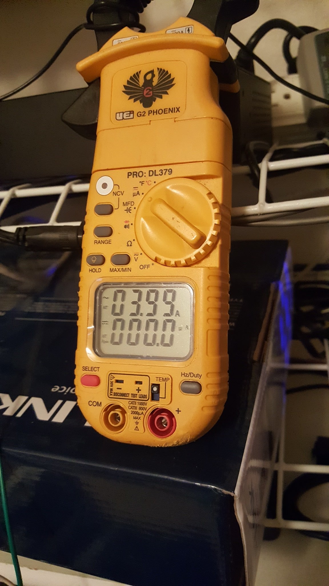

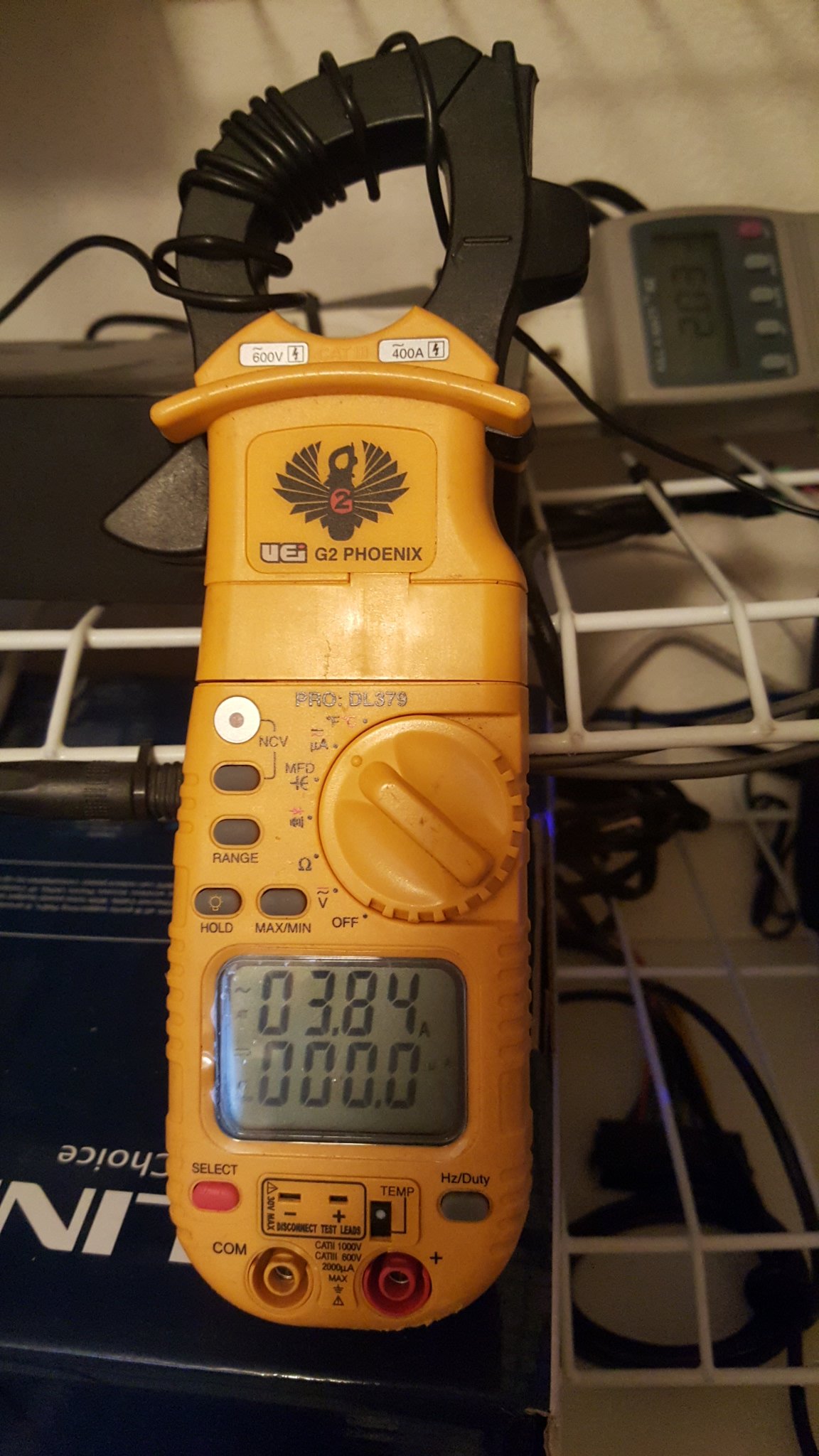

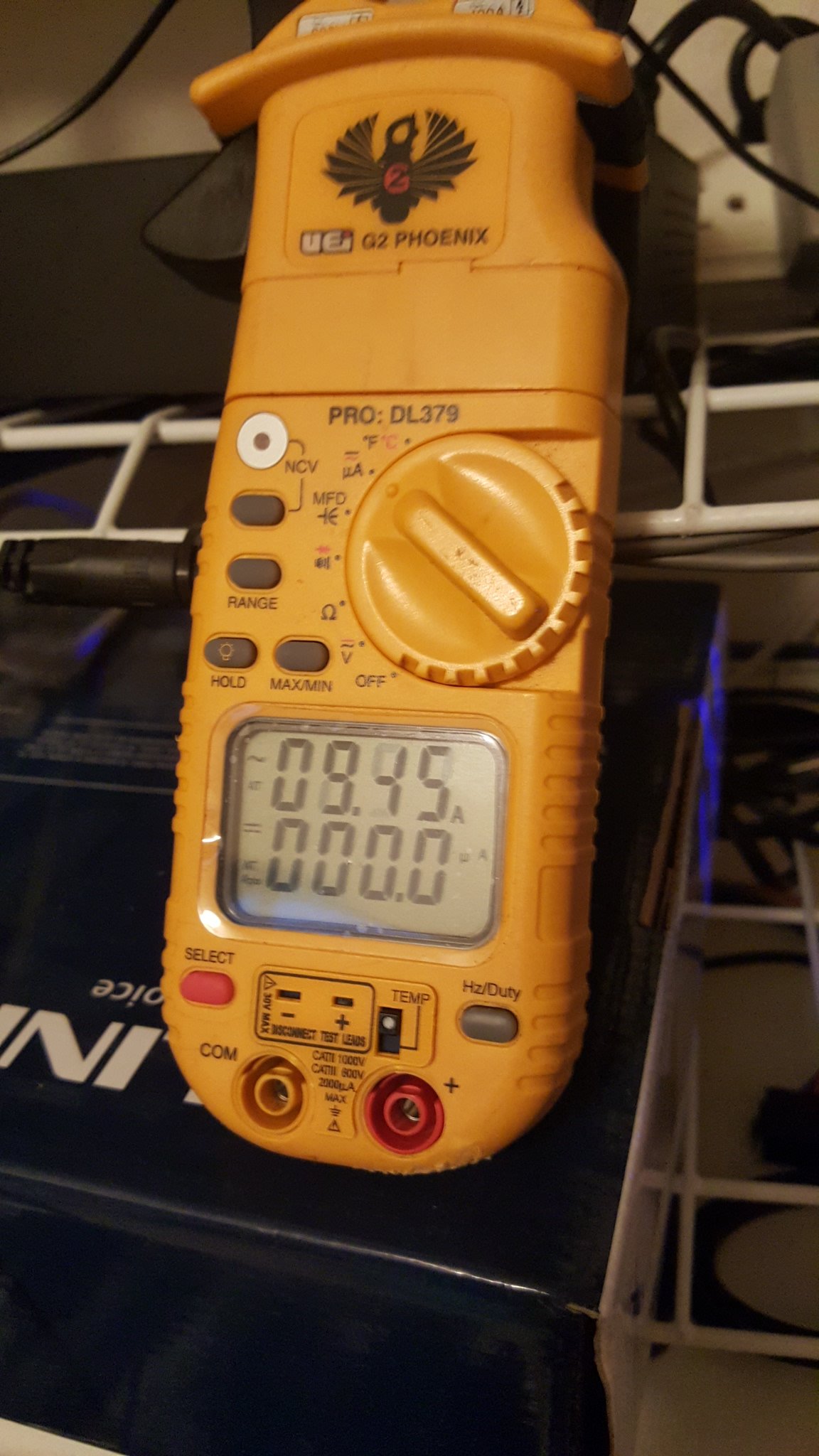

Skinned the power cord, she looks so naked... :) I can do as many wraps as you wish now!  I did ten wraps around the clamp, trying to stay between the little marks on the clamps. I assume that is where they want you to place the wire that I am testing.
Loops around the Clamp: 10
Starting: 9.45A (Highest)
Starting UnRaid: 3.99A (Highest)
Idle with UnRaid: 3.85A (Highest)
Shutting down: 3.84A (Highest)
Voltage: 117.5V  Voltage was in motion during monitoring but almost always came back to 117.5.
Are these numbers workable to inform you what my system needs in terms of a UPS? I'm looking for an absolute, just confirmation. :)

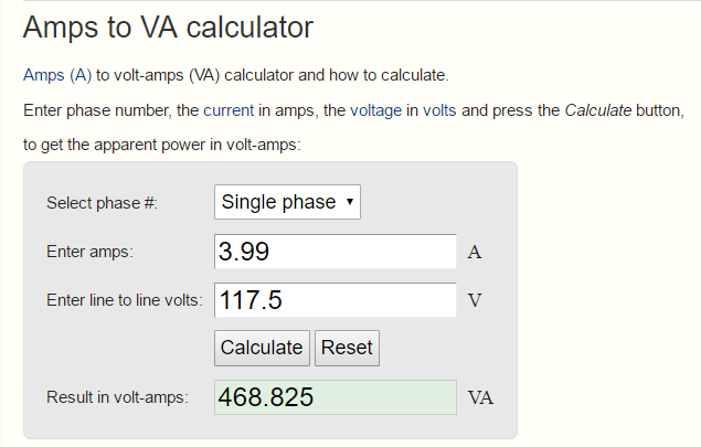

Using the online calculator, it gave me 468.825 VA. Is this the number that I should work with?
Close, but no. You forgot to divide the amps by the number of passes through the clamp, 10 if you counted correctly, and you want the absolute worst possible scenario, so the highest amp draw you actually measured was 0.945 Amps, giving you a max draw of around 112VA. It looks like your meter was off by about 10%, since you originally measured only 0.82 Amps before multiplying the signal with the wrap trick.
That's only the server itself, you need to account for all the other equipment that you would possibly connect to the UPS for peak load capacity. That said, if you truly were ONLY connecting the server to the UPS, you could get away with one of the little beefy power strip looking ones, but you would probably get less than 5 minutes runtime before the batteries were completely dead.
Now that you have a VA figure and can calculate loads for what you need to power, you can get a better idea of runtime by using the % full load figures. I'd recommend at least starting with 500VA as a minimum UPS capacity, and find the runtime charts for the models you are interested in to see what kind of minutes you can get draining the batteries. Then figure half that runtime to avoid abusing the batteries.
Do you recall reading this instruction on how to count the 'turns' or 'loops'
You have got me thinking.  You said you did ten wraps around the clamp.  That would put 11 wires inside of the closed clamp.  So you should be dividing the reading by 11 NOT 10!  (You do the loops/coils because most of these units have very poor accuracy at the low of their measurement range!)  So your Max VA =   9.45/11    X 117.5   = 101VA    That is the figure, I would be working if I truly believed that your meter was capable of reading instantaneous peak current.  What I would use would be this figure 114VA.  Where did I get that.  A very conservative estimate of peak starting current for hard drives is 2amperes per drive.  You have three drives  so
2A/drive  X  12V  X  3drive   = 72VA      and    3.85A/11  X 117.5  = 41.125VA       Total instantaneous VA requirement on drive spinup is 72VA   +  42VA   = 114VA
So the numbers are actually in fairly close agreement.  (Your newer drives probably have a slightly lower peak current draw than drives with older designs did.)  But you have to ask yourself about what plans you have for expansion of this server and how are you going to do it.  Are you going to add more drives  or   Are you going to replace the current drives with larger capacity drives?   That 230W PS is going to limit what you might want to with regard to the first option. You also have to keep in mind that 230W limit when you are looking at the ampere ratings on the individual voltage buses as their total wattage often exceeds the power rating of the PS and that rating is a hard limit.  Exceed that rating and most PS simply shutdown!

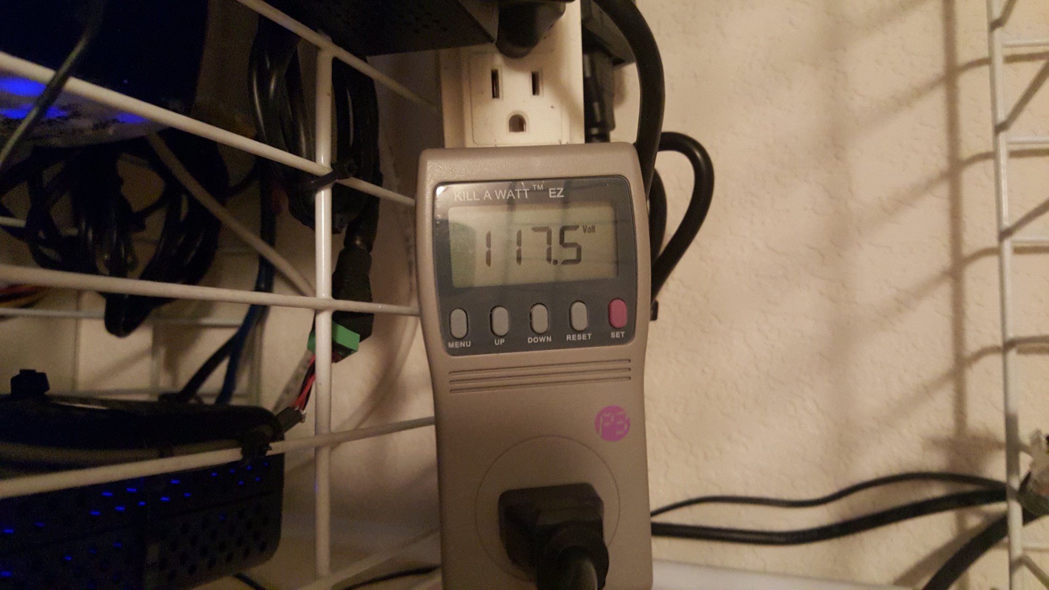

Using your Kill A Watt EZ, hit the MENU button until Volt is showing, like in your pic.  Then use the UP or DOWN button to cycle through the readings until you get power factor (PF), Watt, and VA.  Test and record peak power-on VA and peak Watt.  Record for idle with drives down and idle with drives up.  UPS's are rated in VA (apparent power), with usually around 0.6 to 0.7 power factor being used in the calculation.  They will also list real power in Watts in the specifications.  Looking at amps is not going to tell you much without knowing power factor.  Computer power supplies are inductive and resistive loads.  Once you have your VA and Watt numbers you can plug that into a web site like APC and they will calculate approximate run times for a given UPS.  Your 80+ Bronze should be fine with a stepped approximation UPS, but if you go 80+ Gold or better the active power factor correction circuitry in the power supply may or may not work well with the high current draw and THD when using a stepped approximation UPS and a sine wave UPS would be a better choice. Some supplies are better at handling it than others. APC recommends 25% above power supply rating when using a stepped approximation UPS and a power supply with active power factor correction. Ex: 280W x 1.25 = 350W. Something in the 650-700VA range.

Wow, never knew that the Kill a Watt could provide so much information. It's currently in use between the server and the wall. UnRaid is running at idle during these readings:
122.1 V
.87 PF
.36 A
38 W
44.2 VA
59.9 Hz

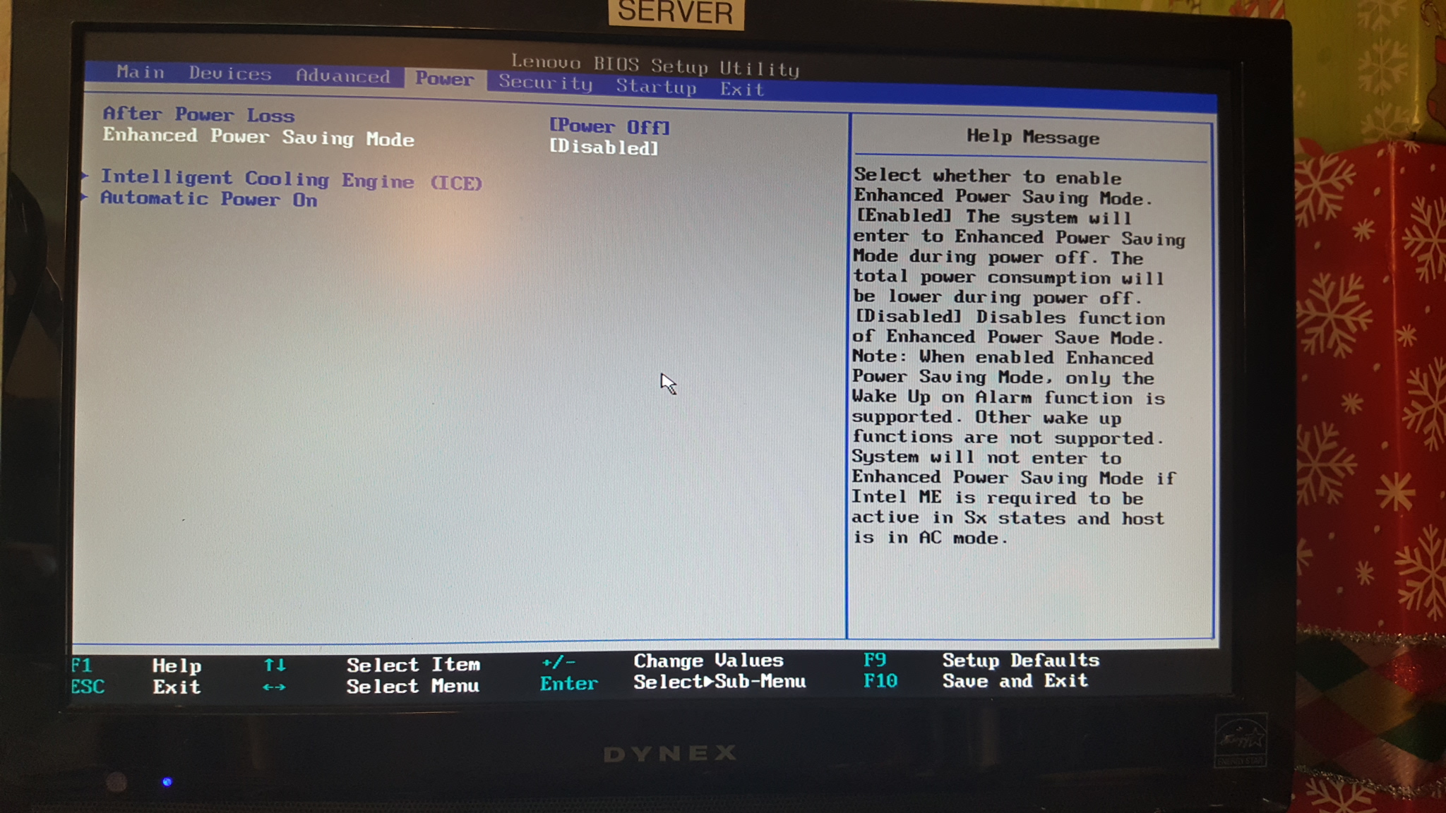

Next question, will the server be able to boot on its own upon restoration of street power? How could this be achieved?
Often this can be accomplished with a BIOS setting. Whether it is a good idea or not is debatable.
I usually prefer to be there when my server boots so I can take a look and make sure everything is working well. Some even go so far as to not have the array autostart on boot until they have checked on it, to make sure all the disks were found, for example.
Which reminds me, I need to take care of this myself so my housesitter can watch Plex without complication while I'm on vacation. Seems we often get a power out in this situation.
Also keep in mind that if you get power cuts back to back where your server auto starts when the ups battery is already low, and you get another power cut, your server may not have enough time to shut down safely. I like to start the server manually (or through ipmi) after making sure the ups battery has enough juice for another power cut
Great points. I changed it to Power Off after a power loss.
