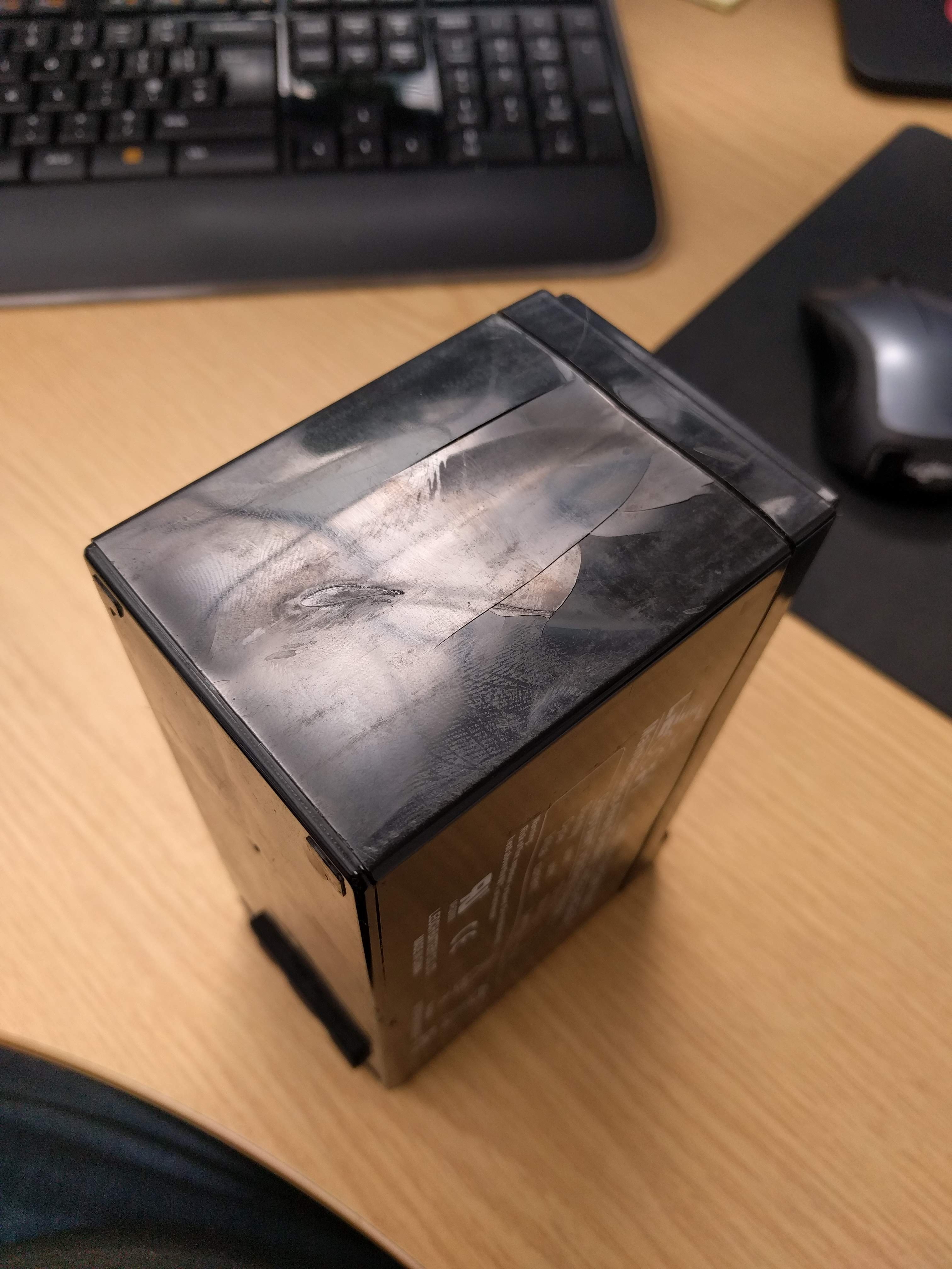

Well, I had a spare five minutes, so I went at it with the screwdriver.  The battery in a CyberPower Value800EILCD is a Leoch DJW12-9.0 (12V9.0AH).
Replacements here cost about £20, so it's worth trying to see whether it'll come back from the dead.
Inspection shows the battery has two vertical cracks on one end with an indent in the middle (ignore the dramatic looking smear, that;'s just a blemish in the plastic).  It also rattles when lightly shaken.
Might explain why the UPS is dead...
