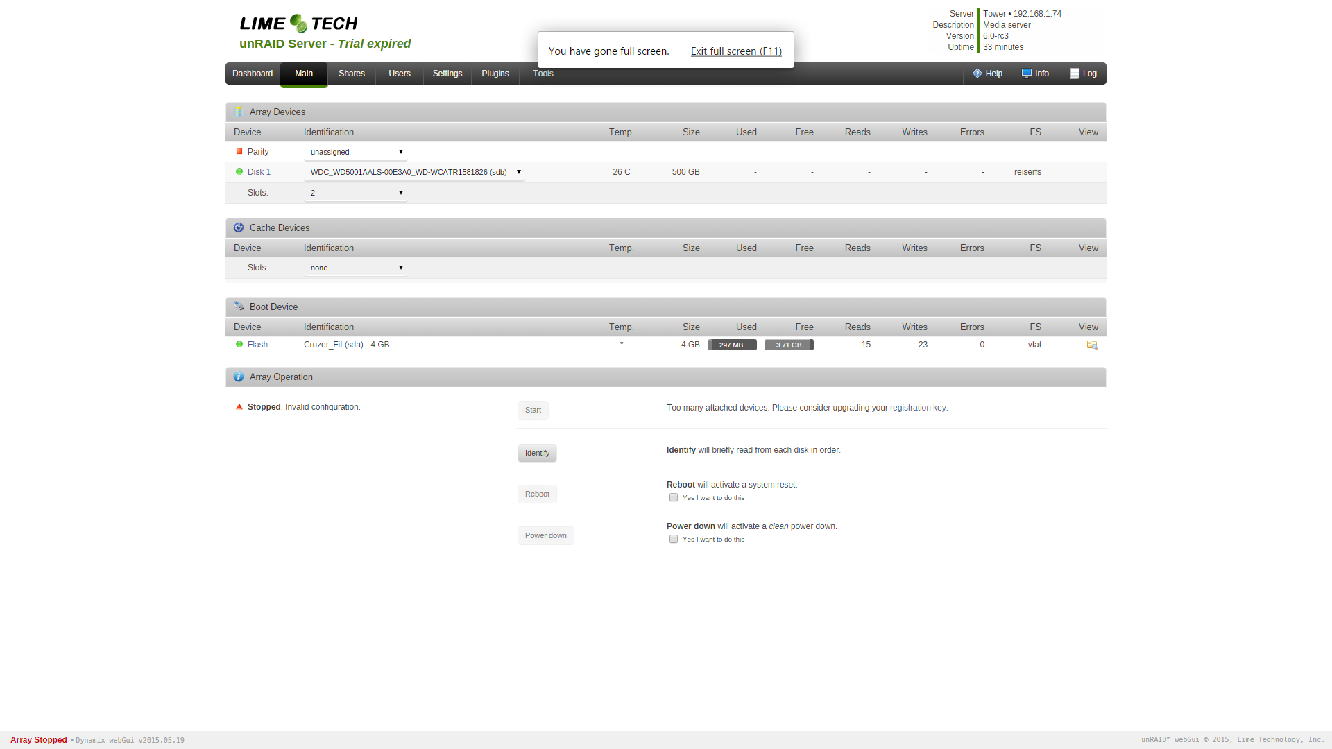

I updated from 6.0 beta15 trial to Release 6.0-rc3 today and i wanted to use the trial until next month but it said that there are too many devices when in fact only had one disk installed (exluding flash).
I tried to restart and now it says the trial is expired.
so i'm stuck with a OS that won't start because it thinks i have more disks than i have and says my trial is expired.
please help.
Note that the limit applies to devices attached to the server - not just those installed into unRAID.  Do you have any other disks in the server that unRAID is not using?
no i do not
no i do not
Ok.  The other issue is that the server time needs to be accurate within 5 minutes.
i changed the time to the correct time and it worked  :D thanks!

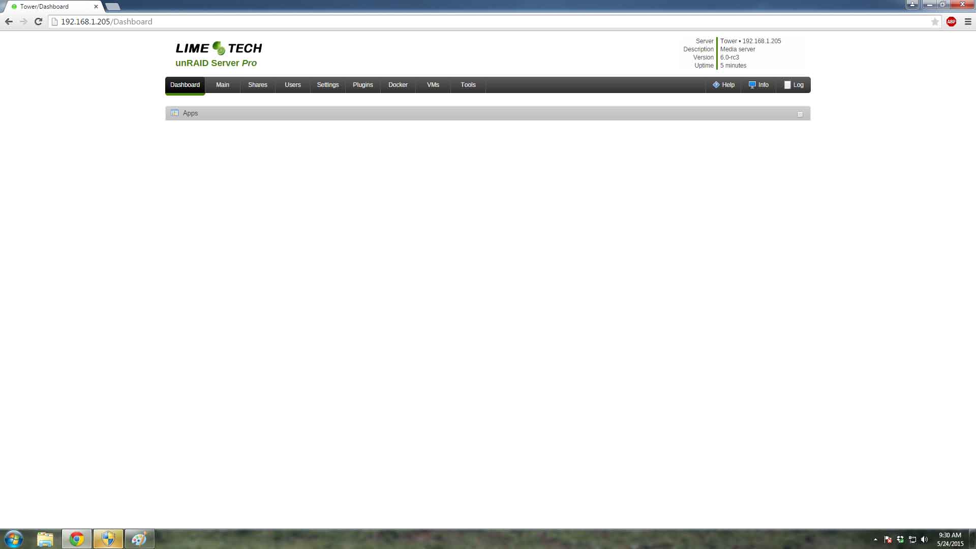

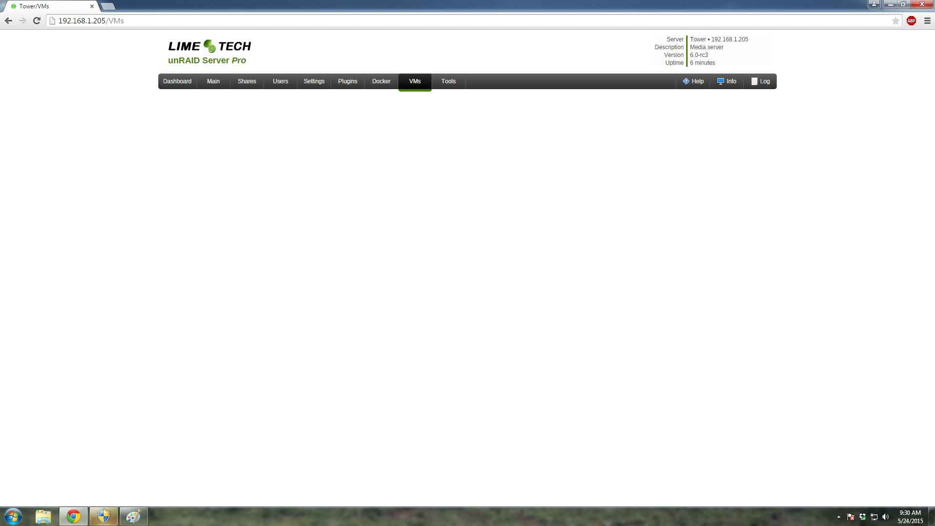

Does anyone know why the VM page in the webgui will not start? When I start my server there is no tab for the VMs.
Also libvirt does not start and I have to start it manually with /etc/rc.d/libvirt start. Once I do this, I get the VMs tab but when I open it, it is blank see attachment.
Also this seems to crash the dashboard, this page could be viewed before libvirt was started.
My syslog is here http://pastebin.com/EwTLXUyg hopefully someone knows why this is happening. It has been this way since beta12. Its annoying. Thanks
Have you enabled VM support under Settings->VM Manager?
I expect this is not started until you have enabled VM support.
I see, unfortunately when I click on the VM Manager under settings the page is also blank..
