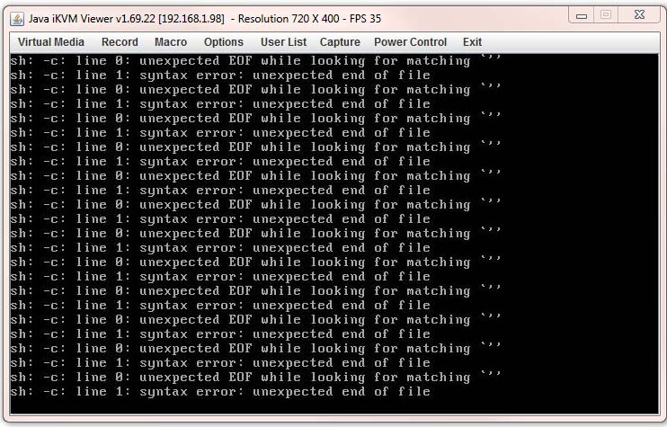

Anyone know why i'm getting these errors in my console?  I think it's been doing it since b15 or so..  Server is working fine though.
Boot in SAFE mode
Sorry, I had to step away. How do I do it? Is safe mode the same thing as the maintenance mode option?  Thanks.
No.  Safe mode is an option on the boot menu and means that unRAID loads without non-standard plugins but starts as normal.  Maintenance mode is when the array is started but the array disks are not mounted and is typically used to check for or recover from file system corruption..

Thanks.  I am running headless but with kvm support.  I rebooted unraid in safe mode(without plugins) but there's no indication that i'm actually in safe mode. Everything looks normal and i'm still having those eof errors in the console.
What I think i'm going to do is wait for the final release to come out and then if it's still happening I will switch to a totally fresh usb stick with the final version on it.

If this is not on limetech's radar then I doubt you will see it fixed with the final version. Attach a syslog. See v6 help in my sig.
This is probably a problem on a plugin. Which plugins are you running?
Thanks. I'll read it over and try and send them a syslog this evening.
So far i'm still running stock unraid, even have docker turned off.  The only thing I have installed is unmenu and the preclear script.
