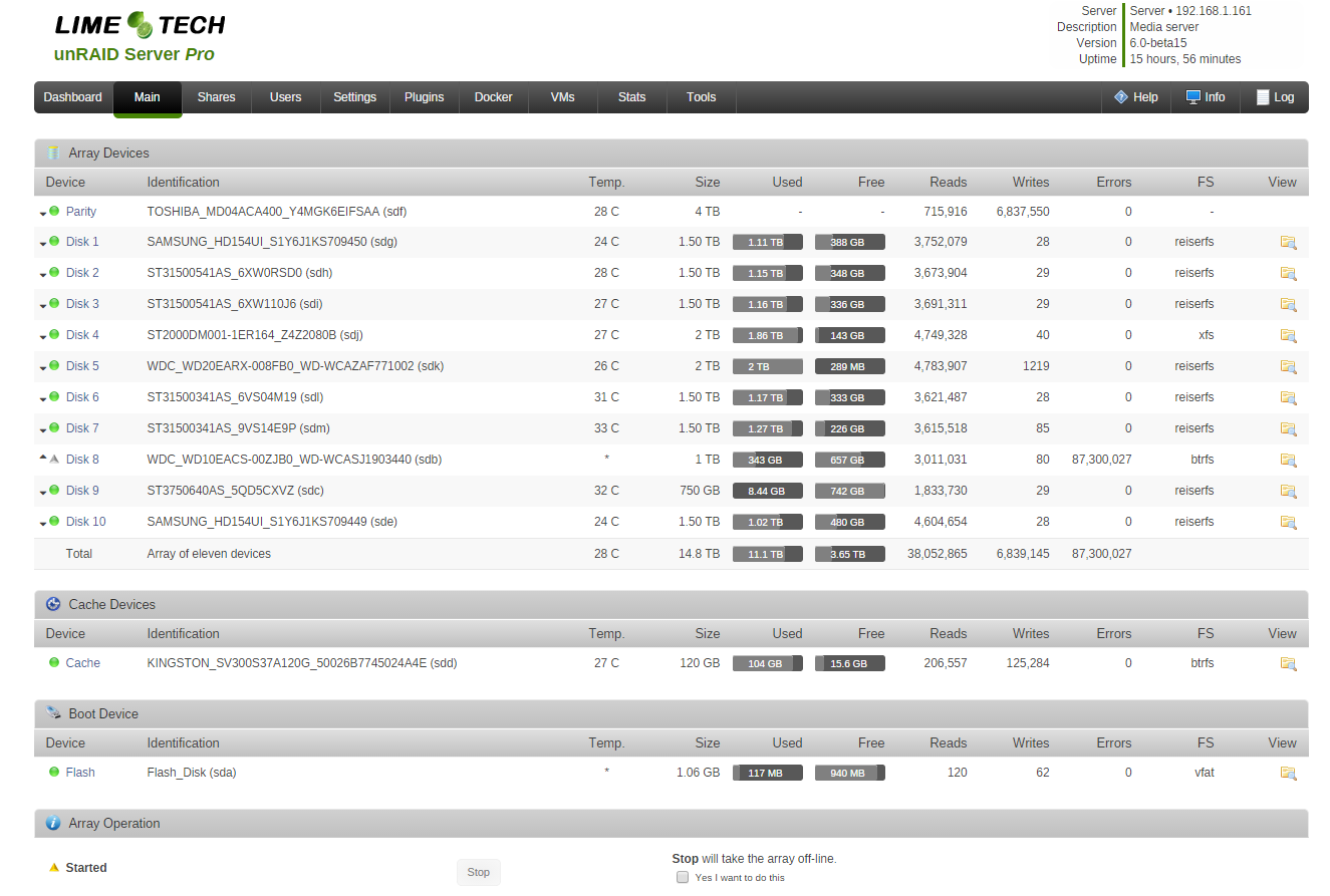

I just replaced my parity drive from a 2TB to a 4TB drive.
I ran a parity check prior to removing the old drive with 0 errors.
New parity drive ran 3 cycles of preclear with no issues prior to becoming the new parity drive.
During parity rebuild I received a notification that one of my disks had read errors.
Parity rebuild completed successfully, and supposedly all is well.
The number of errors on the main page for that 1 disk (my only array disk that is BTRFS) is 87,300,027.
I am not sure what this means exactly, the server thinks everything is fine, device is not disabled, etc...
This drive has no history of SMART errors, etc....
I am currently running a scrub to see if it finds any issues (not exactly sure what that is supposed to do for this situation).
So what exactly does read errors mean (especially THAT many!)?. I assume since the rebuild of parity was successful that the data from that drive was able to be read?
I have another 4TB I plan to install, however I don't want to do anything until I know that I am not making things worse.
I have the old parity drive here if I had to put it back in to (I guess) rebuild the data that could be bad on the drive with the read errors.
Steps/suggestions and what this means exactly would be very appreciated.
I'd grab a system log, however it seems with the BTRFS scrub running it refuses to come up in the GUI, it is just blank, and a download of it is an empty file.
Also, still running 6B15 (figured I'd upgrade after the parity disk swap).

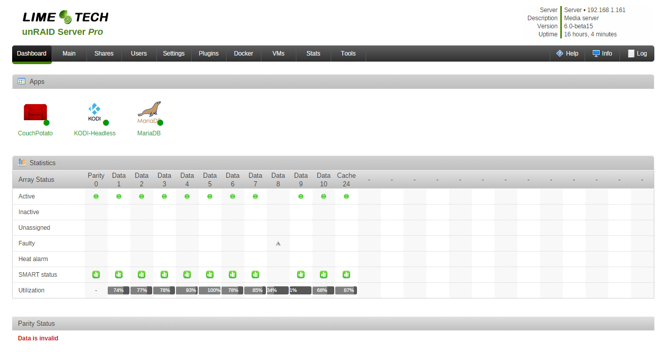

This may or may not be odd, but once I hit scrub for that drive unRAID told me that "Disk 8 in error state (disk dsbl)" and all drives are now spun up with my array at the bottom showing a yellow triangle, which for the popup on an array drive means invalid data content..
Screenie for better detail attached.
I attempted to grab a system log from the console with "cp /var/log/syslog /boot/syslog.txt", it also creates an empty file.
According to the Dashboard page, it states that "Parity Status Data is Invalid", screenie attached

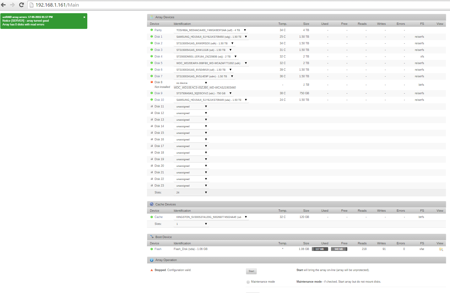

Scrub finished with zero errors, all was well, stopped the array
Attached a picture, the disk shows as "Not Installed". However shortly after stopping the array I got the notification (can be seen in the picture also) that:
Event: unRAID array errors
Subject: Notice [sERVER] - array turned good
Description: Array has 0 disks with read errors
Importance: normal
As of right now it shows as no disks present to re-assign to Disk 8.
System log is still blank.
If the disk is showing as not installed when you stopped the array then it dropped offline.    Normally the only way to recover from this is to reboot the server.  Why it dropped offline is the issue?  It is worth checking that you have not disturbed the power or SATA cables for that drive.
