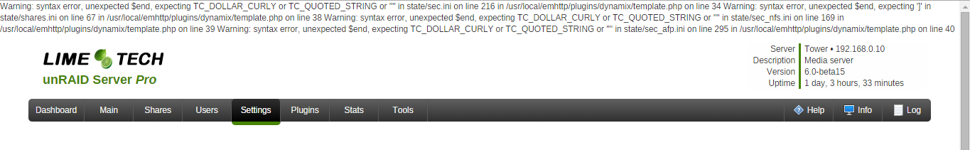

First boot, everything went well, did my configs, had access to all the icons in the WebUI. And get that message on top of the WebUI:

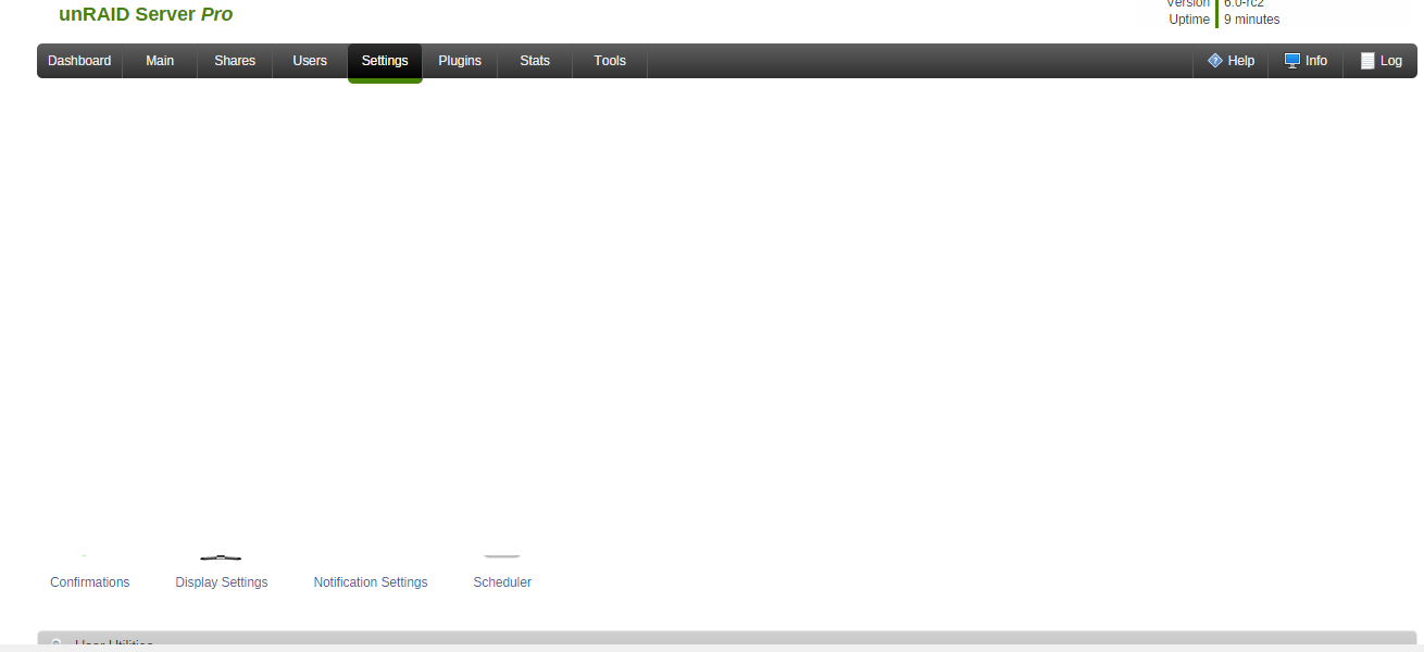

The issue began when I started the array. I will loose the icons on the top of each and every tabs (attachment), Dashboard, Main, Shares, Users, Settings, Plugins, Stats and Tools.
Warning: syntax error, unexpected $end, expecting TC_DOLLAR_CURLY or TC_QUOTED_STRING or '"' in state/sec.ini on line 216
in /usr/local/emhttp/plugins/dynamix/template.php on line 34
Warning: syntax error, unexpected $end, expecting ']' in state/shares.ini on line 67
in /usr/local/emhttp/plugins/dynamix/template.php on line 38
Warning: syntax error, unexpected $end, expecting TC_DOLLAR_CURLY or TC_QUOTED_STRING or '"' in state/sec_nfs.ini on line 169
in /usr/local/emhttp/plugins/dynamix/template.php on line 39
Warning: syntax error, unexpected $end, expecting TC_DOLLAR_CURLY or TC_QUOTED_STRING or '"' in state/sec_afp.ini on line 295
in /usr/local/emhttp/plugins/dynamix/template.php on line 40
If I stop the array, the icons will comeback.

My shares are accessibles. The system is working. Except I can't get access to the Docker icon to do the setup since its only working when the array is started and all the others top icons at the top  of each tabs.
In the web browser of my cell phone and tablet (Android), if I scroll down the page (on landscape view) I will be able to see some of the icons for a second, but I wont be able to select them because they will disappear as soon that I will leave my finger from scrolling.
