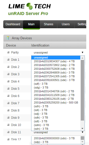

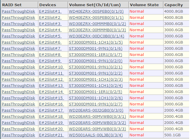

In moving over my actual hardware it now looks like I'm encountering the following issue. The areca/HP sas expander is able to pass on all 21 drives (1 cache, 1 parity, 19 data drives). During my test scenario with 21 other drives, windows was able to see them. Then when I tested with 3 of those test drives they worked fine in unraid.
However it looks like unraid is unable to resolve more than 8/9 of them, giving them wonky "(sd#)" titles and not showing the actual serial's. So I cannot line up the data drives the way they previously were.
Any advice?

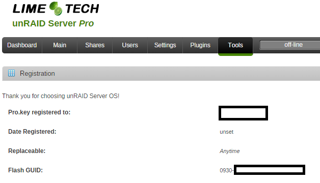

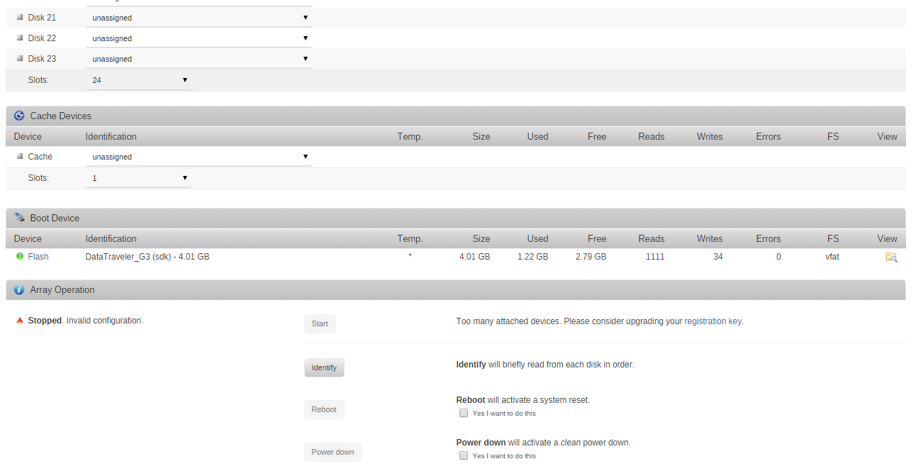

I've followed the guide and names are now shown for all my drives. It looks like I am unable to start my array. It's showing that I have too many drives attached. Even when I none are in any of the drop downs. I'm wondering if changing hardware has corrupted my pro key?
I seem to remember this message also occurring if the date/time was wrong on the server.  Might be worth checking that.
The attached device limit was removed in RC3 => upgrade to that and all should be well.
Updated to RC3 and reloaded all my disks in. Started it up and everything is there. You guys are champs I appreciate the help. If anyone lived near Toronto I'd have you over for beer and steaks!  ;D
