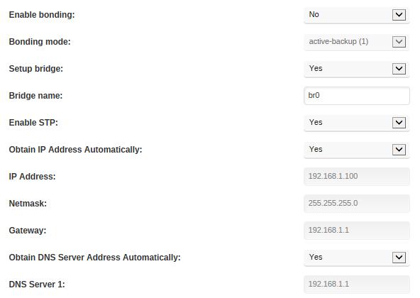

My network setting are attached, but aren't anything out of the ordinary.

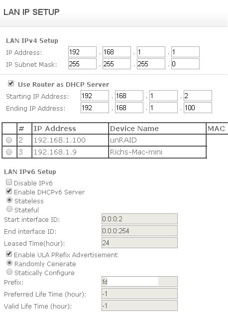

post your DHCP settings page from the sky router.
There's definitely no duplicate IPs. As for isolating the router, unRAID and a Mac, i wont be able to do that until the weekend, but i will give it a go. Good idea!
Router settings attached (I took out the majority of IP reservations, but left two in as an example)...
