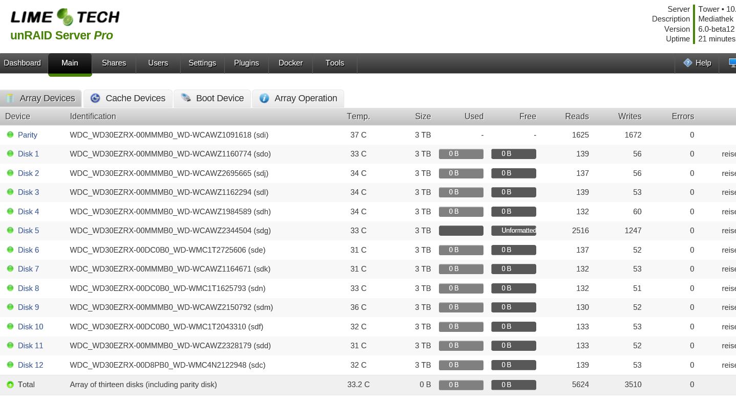

Hello,
I'm using Unraid 6.0-beta12.
I was copying large amounts of data to the hard drives for days. I noticed this morning, if I delete files, they reappear after I refresh the share. So I restarted the unraid Server. After the restart one disk (5) is shown as unformatted. Stop Array Operation from the Webgui doesn't work. Array can't be stopped anymore. Smart Status of all disks show that everything should be fine.
Please help to recover my Server.
Thanks in advance.
Roadini
Unraid_log.txt
Unraid_System_log.txt
Screenshot from unraid web gui

I would love to, but I can't stop Array (see above). Furthermore other disks of array look "strange" (see picture of second post).

Seems like one of my AOC-SASLP-MV8 has a Problem. Tells me on all 8 Ports of that one Adapter that PD Disk down. Other Adapter doesn't bring up any failures. I'll wait for the check error log and than look into the Adapter.
Well Adapter works fine. Shut down the Server and made sure both Cards are seated fine. No Pd Disk Down Errors anymore while starting up.

"REISERFS error (device md5): vs-5150 search_by_key: invalid Format found in block 26745501.
rmdir: failed to remove '/mnt/disk5' : Device or ressource busy"
