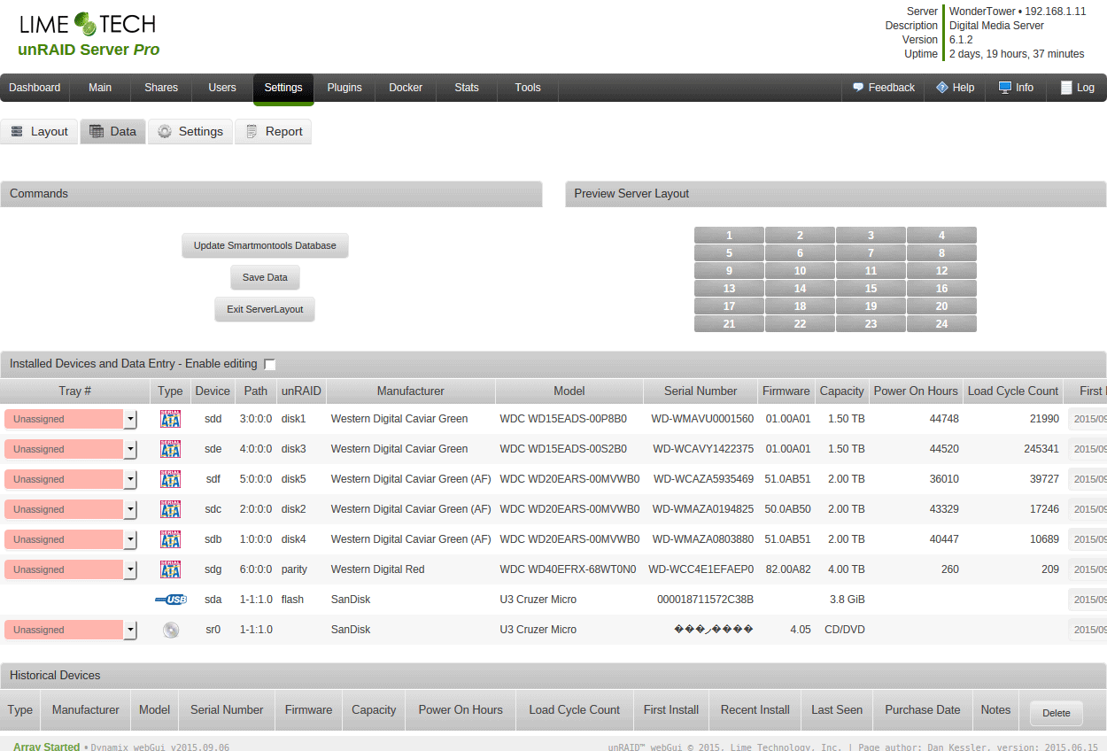

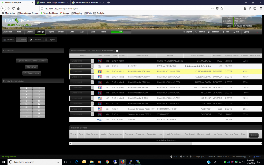

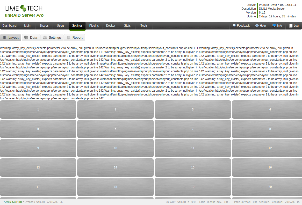

I installed the plugin and tried to use it but it doesn't seem to save the information. There is also a bunch of php errors when the plugin first loads up the layout page:
Warning: array_key_exists() expects parameter 2 to be array, null given in /usr/local/emhttp/plugins/serverlayout/php/serverlayout_constants.php on line 111 Warning: array_key_exists() expects parameter 2 to be array, null given in /usr/local/emhttp/plugins/serverlayout/php/serverlayout_constants.php on line 111 Warning: array_key_exists() expects parameter 2 to be array, null given in /usr/local/emhttp/plugins/serverlayout/php/serverlayout_constants.php on line 111 Warning: array_key_exists() expects parameter 2 to be array, null given in /usr/local/emhttp/plugins/serverlayout/php/serverlayout_constants.php on line 142 Warning: array_key_exists() expects parameter 2 to be array, null given in /usr/local/emhttp/plugins/serverlayout/php/serverlayout_constants.php on line 142 Warning: array_key_exists() expects parameter 2 to be array, null given in /usr/local/emhttp/plugins/serverlayout/php/serverlayout_constants.php on line 142 Warning: array_key_exists() expects parameter 2 to be array, null given in /usr/local/emhttp/plugins/serverlayout/php/serverlayout_constants.php on line 142 Warning: array_key_exists() expects parameter 2 to be array, null given in /usr/local/emhttp/plugins/serverlayout/php/serverlayout_constants.php on line 142 Warning: array_key_exists() expects parameter 2 to be array, null given in /usr/local/emhttp/plugins/serverlayout/php/serverlayout_constants.php on line 142 Warning: array_key_exists() expects parameter 2 to be array, null given in /usr/local/emhttp/plugins/serverlayout/php/serverlayout_constants.php on line 142 Warning: array_key_exists() expects parameter 2 to be array, null given in /usr/local/emhttp/plugins/serverlayout/php/serverlayout_constants.php on line 142 Warning: array_key_exists() expects parameter 2 to be array, null given in /usr/local/emhttp/plugins/serverlayout/php/serverlayout_constants.php on line 142 Warning: array_key_exists() expects parameter 2 to be array, null given in /usr/local/emhttp/plugins/serverlayout/php/serverlayout_constants.php on line 142 Warning: array_key_exists() expects parameter 2 to be array, null given in /usr/local/emhttp/plugins/serverlayout/php/serverlayout_constants.php on line 142 Warning: array_key_exists() expects parameter 2 to be array, null given in /usr/local/emhttp/plugins/serverlayout/php/serverlayout_constants.php on line 142 Warning: array_key_exists() expects parameter 2 to be array, null given in /usr/local/emhttp/plugins/serverlayout/php/serverlayout_constants.php on line 142 Warning: array_key_exists() expects parameter 2 to be array, null given in /usr/local/emhttp/plugins/serverlayout/php/serverlayout_constants.php on line 142 Warning: array_key_exists() expects parameter 2 to be array, null given in /usr/local/emhttp/plugins/serverlayout/php/serverlayout_constants.php on line 142 Warning: array_key_exists() expects parameter 2 to be array, null given in /usr/local/emhttp/plugins/serverlayout/php/serverlayout_constants.php on line 142 Warning: array_key_exists() expects parameter 2 to be array, null given in /usr/local/emhttp/plugins/serverlayout/php/serverlayout_constants.php on line 142
I am using Unraid 6.1.2 and Firefox 40.0.3.
I just tested on Firefox 40.0.3 and plugin verison 2015.06.15 and it is running OK - no errors.
What version of the plugin are you running?
I assume you have drives installed.
Can you post a screenshot of the main unRAID window?
I'm using the latest plugin version: 2015.06.15
Please also post:
"/boot/config/plugins/serverlayout/serverlayout.json"
Also post your main unRAID screen - for some reason your USB is also seen as an optical drive !?

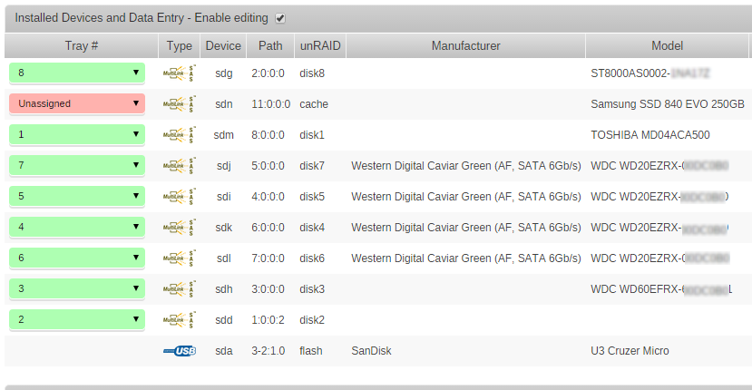

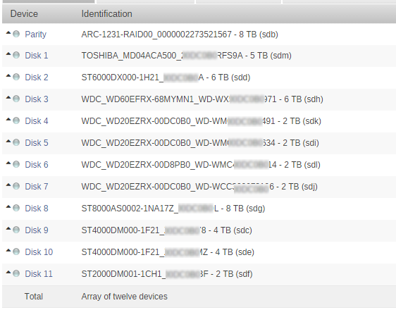

All drives connected to my Areca ARC-1231ML do not show up as available for setup. Once you have them, another issue will arise... my parity volume occupies 2 slots :) Its a RAID0 of 2x4TB HGST.
One other... my cache drive is not in a slot. I mounted it at the back of the case through the fan grill. Any ideas on how to show that?
Please post output of "ls -las /dev/disk/by-id".
and "lsscsi" and "lsscsi -t"
Regarding the RAID0 - I will check the output you provide first.
Regarding the external cache - try adding rows/column with hidden slots/trays.
Please also post the output of "smartctl --all /dev/sdf"
This is how I get the disk information.
I think the ARECA doesn't give back the internal disk information especially the serial number and that is why they are overwriting each other's data and only the last one "disk2"/"sdd" remains - and as you see it does not have a serial number or any disk information.
smartctl 6.2 2013-07-26 r3841 [x86_64-linux-4.1.7-unRAID] (local build)
Copyright (C) 2002-13, Bruce Allen, Christian Franke, www.smartmontools.org
=== START OF INFORMATION SECTION ===
Vendor:               Seagate
Product:              ST2000DM001-1CH1
Revision:             R001
User Capacity:        2,000,398,934,016 bytes [2.00 TB]
Logical block size:   512 bytes
Rotation Rate:        10000 rpm
Logical Unit id:      0x001b4d2306294804
Serial number:        Z1F5DKBF
Device type:          disk
Transport protocol:   Fibre channel (FCP-2)
Local Time is:        Mon Sep 21 16:16:40 2015 PDT
SMART support is:     Available - device has SMART capability.
SMART support is:     Enabled
Temperature Warning:  Disabled or Not Supported
=== START OF READ SMART DATA SECTION ===
SMART Health Status: OK
Current Drive Temperature:     30 C
Drive Trip Temperature:        25 C
Manufactured in week 30 of year 2002
Specified cycle count over device lifetime:  4278190080
Accumulated start-stop cycles:  256
Elements in grown defect list: 0
Error counter log:
           Errors Corrected by           Total   Correction     Gigabytes    Total
               ECC          rereads/    errors   algorithm      processed    uncorrected
           fast | delayed   rewrites  corrected  invocations   [10^9 bytes]  errors
read:          0        0         0         0          0          0.000           0
write:         0        0         0         0          0          0.000           0
Non-medium error count:        0
Device does not support Self Test logging
oh my... its a 10K RPM 2TB Seagate :P
Just so you are on the same page, its a known issue with This card. With the help of other users, I have this in my Go file. Otherwise those drives would be blanks in UnRaid:
cp /boot/60-persistent-storage.rules /lib/udev/rules.d
udevadm control --reload-rules
udevadm trigger
Here is the thread we have for this:
http://lime-technology.com/forum/index.php?topic=38487.0
