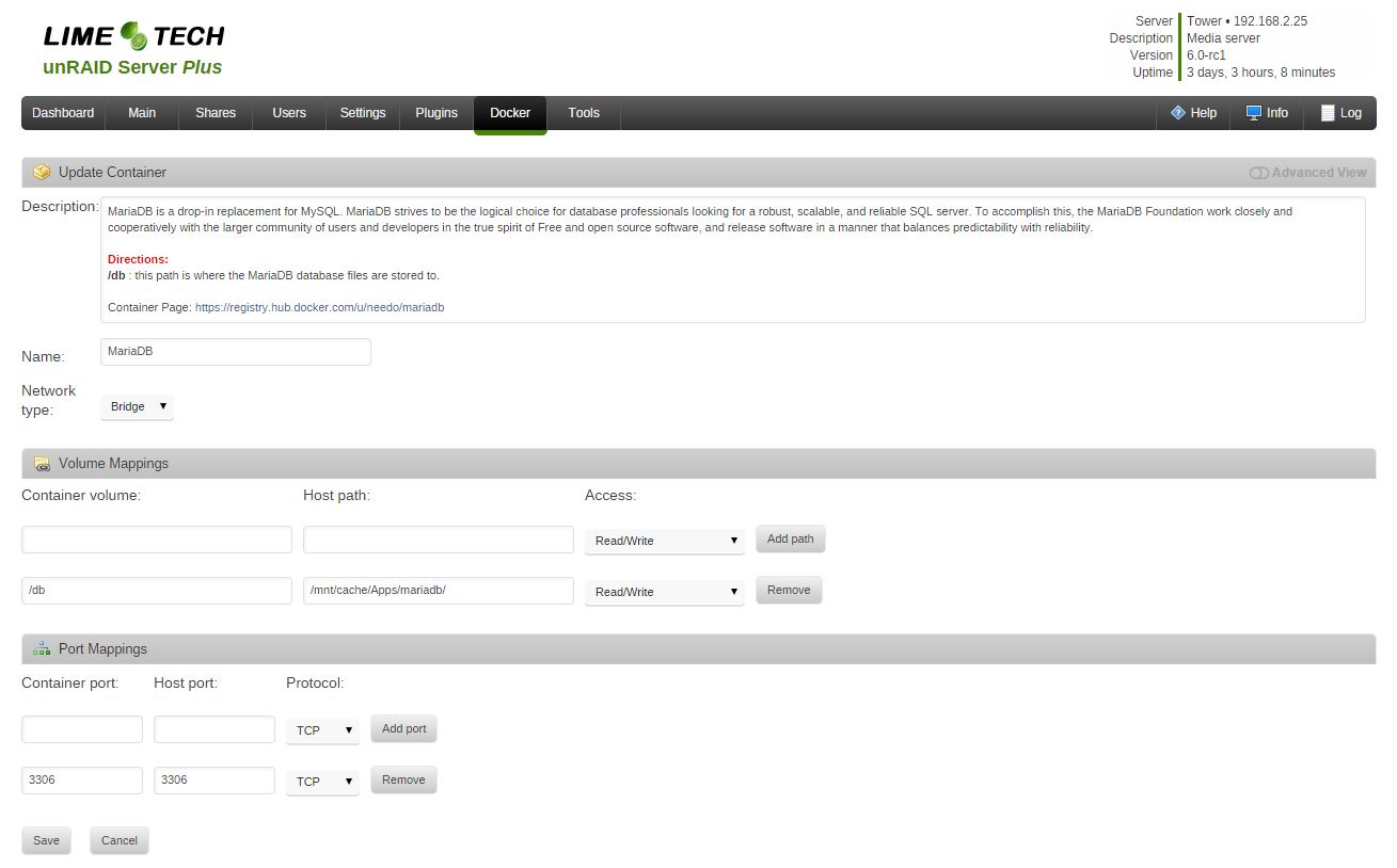

First thing would probably post a screenshot of your mariaDB docker config, and your kodi advancedsettings.xml file
I've attached a screenshot of my mariadb docker config page.  I've tried this mapping to both "/mnt/cache/Apps/mariadb/" and also "/mnt/user/Apps/mariadb/" with no luck.  I've also tried changing from bridge to host mode with no luck either.

Your MariaDB screen shot looks fine, matches mine.
