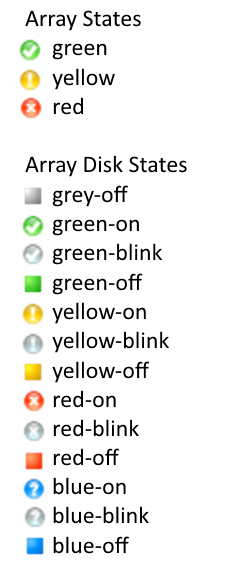

Thanks for reminding us of that thread. The "sixpack status icons" in that thread go down to 32x32. What size are the current icons?
That thread also brings up the MyMain icons. What is the complete set and how big are these MyMain icons? I don't think bjp999 is in this thread yet.
Of all the ideas floated so far, I like this one
... separate the spin status - add a second column with up and down arrows, large enough to click on to spin up or down (hover text could be "Standby - click to spin up" and "Active - click to spin down")...
I think separating the spin status would clarify things considerably, and would allow for a smaller set of icons/colors for the other state indicator.
We already have the click to spin up/down which has confused some. It currently represents what it would do if you clicked it. It could instead represent the current state and clicking it would toggle the state.
i think bonieni said the current icons were 16x16 somewhere in this thread.

I like them.  I'm unsure about all of the 'offs' being undecorated squares though.  Could there be red/green confusion, or are those never used in the same context?
Could you link these with their meanings/purposes from Tom's first post - 3 Array States, 9 Array Disk States (5 and 4), 4 Cache Disk States, and 3 User Share States.
I'd prefer separate columns for spin status and drive status, but it would require a little more coding, so I don't think we want that for v6.0 final.  So I'm happy with the above, once their purposes are sorted out.

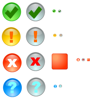

I am not finished yet, here yet another take ...
(this time just the symbols - both large and real size)
FWIW, I am liking these. They make sense to me...

I think everyone likes the blue ball for a new drive.  And for the User Shares state, we don't want a red ball for Cache-only shares, especially a red ball with X.  Need a 4th color.
A color blind user needing support could describe what he sees as the check ball (green with check), the X ball, (red with X), and the bang ball (yellow with '!') (or the exclamation ball).  can't remember what discipline calls it the bang

Then there is no need to mix the spun up / spun down with the other kind of states. The grey triangle is what started this discussion in the first place and the reason it was confusing everyone is because it was trying to convey spin state and something else at the same time.
The other kind of states could still be represented with colored balls as long as the ball also had another symbol inside it like X or ! or a checkmark that would convey the same meaning as the color as already suggested.
(The old hacker's dictionary is where I first encountered ! = bang, some others that nobody thinks about are . = dot, * = star, @ = at)
