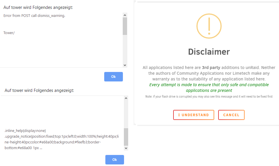

Hello community,
I have following problem to install the CA:
After I install the plugin and try to agree to the disclaimer, following warning pops up and all I can do is approve the warning.

Can you post your diagnostics.  What is the entire message in the popup?
Hi Squid,
eclosed the diagnostic and the popup.
tower-diagnostics-20200103-1445.zip
It's failing marking a flag that you've accepted the warning.  100% related to the boot flash.
What I'm not understanding though is that your boot media is actually being recognized as a 1.8" SSD (32G) which is rather strange.  (Incidentally, the SMART report for it shows that it is FAILING NOW.
What happens if you try a different stick as a boot? (Set it up as a Trial, no need to setup any disks or anything -> After hitting the GUI, install CA and then go to the apps tab)
Just pumped out an update that should hopefully give some more information, rather than everything being stuck in an alert
