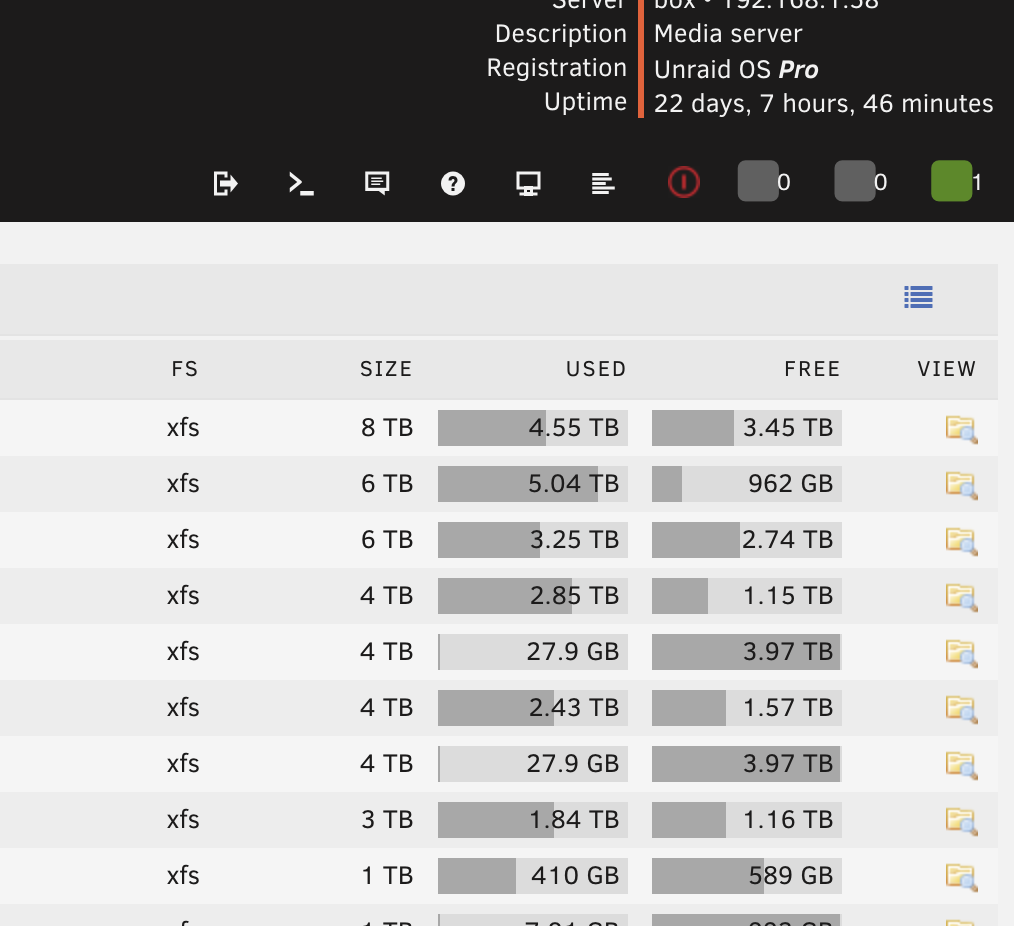

Is it just me or under main tab the icons at top are out of whack (numbers our of their boxes). Shows the same on Chrome and Safari.
Seems normal on all other tabs.
1952648324_ScreenShot2020-06-10at4_46_24PM.thumb.png.b7e5cb247c43e8ba371e2978df3a7dab.png
It's an issue with the UD plugin, already reported and it should be fixed on the next update.

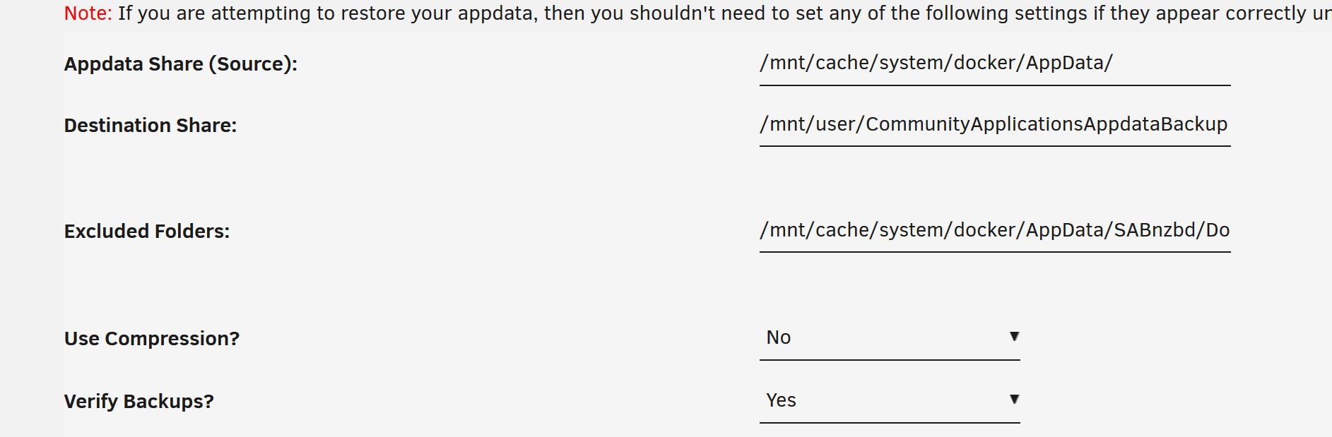

If I'm using this application to backup my Community Backup Folder, that means I don't have to backup my \cache\system\docker\AppData folder, correct?
I just installed CrashPlan and want to make sure I'm getting everything backed up, but not duplicating things unnecessarily.
4 hours ago, Squid said:
Only if you also want it in the cloud.
Sorry, I'm a little confused.  If I'm using CA to backup the AppData folder and then CrashPlan to backup the file created by the CA backup, I no longer need to backup the /cache/system/docker/appdata folder is I guess what I'm asking.  Everything in the CA backup file is in the AppData folder, so it would be redundant, right?
Thanks!

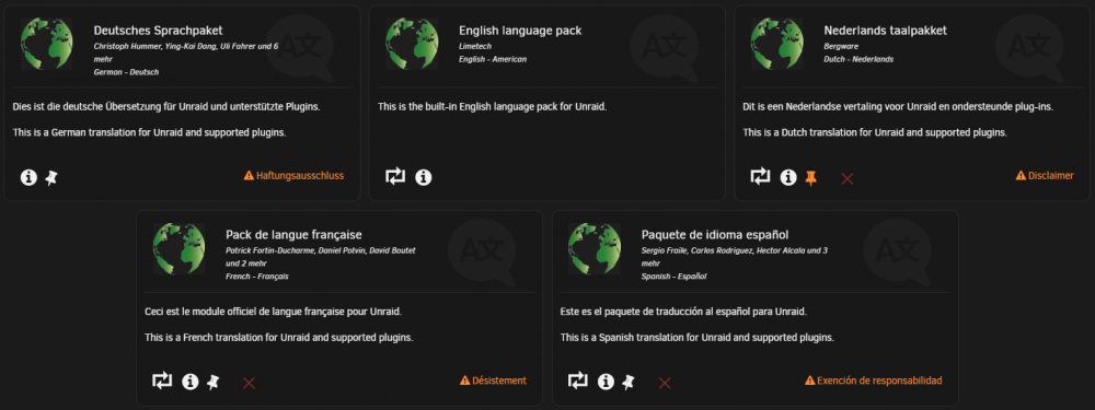

Languages
Using Community Applications is the recommended way to install any language packs from Limetech when you are running a version of unRaid (6.9.0-beta22+) which supports this feature.
To do this, navigate to the "Language" Category.
The download icon will install a language pack, and the "switch to" icon will immediately switch to that language.  Additionally, you can delete any installed language packs by clicking the red-x.  More information regarding the language (change logs etc) will be displayed via the More information icon (or clicking the Icon for the language pack).  If an update is available for the language pack, then an appropriate update icon will also appear)  The hover text for the download and switch to icons (and within the popup) will always appear in the language of the tile (ie: the Hover text to download Dutch / Switch to Dutch will always be in Dutch) to assist non-English speakers to switch the OS to their chosen language.
It is however outside of the scope of translations for any descriptions / overviews of any given application to be translated to a chosen language (in otherwords, the description of an application will always appear in the author's chosen language (ie: English))
If you inadvertently switch to a language and get completely lost trying to switch back to English, there is a new additional "switch to English" icon which will appear on unRaid's tab bar that will immediately revert the system back to English.
Note:  You do not have to agree to CA's start up disclaimer in order to install / manage languages.  Additionally, translations into a selected language may not be available for any of your plugins, even if they support Multi-Language.
