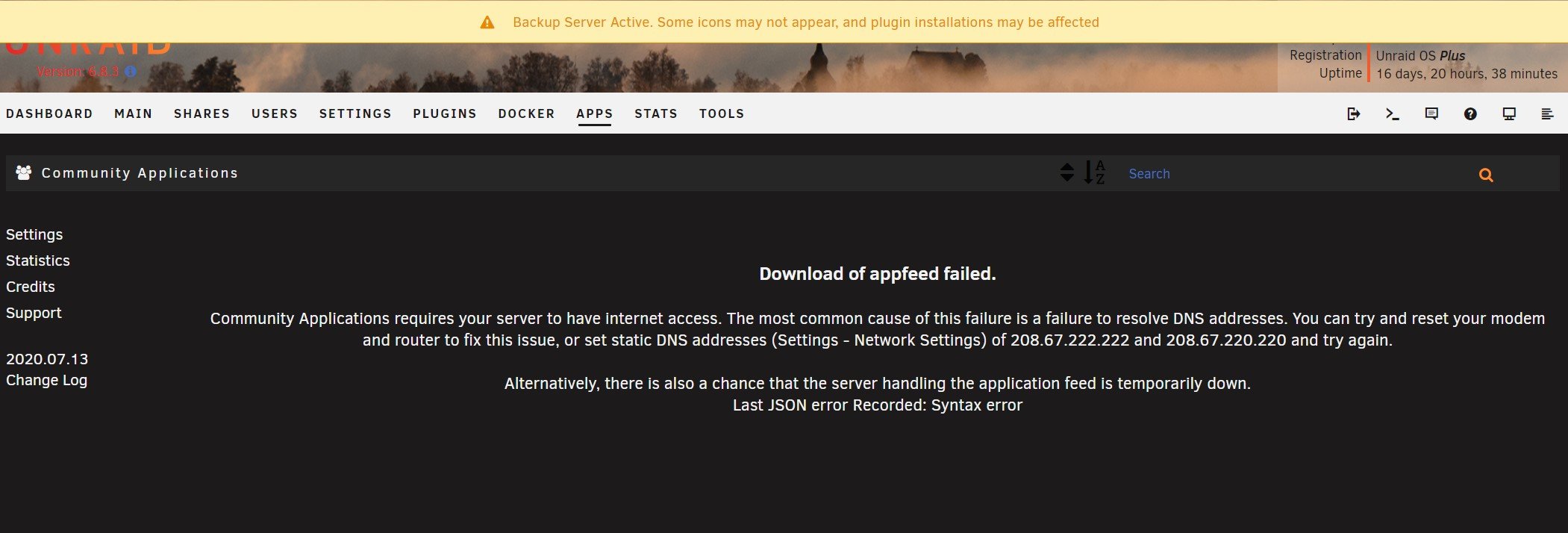

Hi, is there some maintenance or problems going on with CA related infrastructure?
I've been getting this error (see image) often the last couple of days, I've been going through my network and rebooted routers, DNS settings etc but it seems to be OK.
This occurs randomly a couple of times per day during the last week I would say.
I'm on UnRAID 6.8.3 and CA plugin 2020.07.13 and I haven't seen this error before the last week.
Try setting the DNS in settings - network, not in the router.   While it's possible the issue isnt there, there are 2 servers with an automatic fallback between the two, and the odds aren't very good that both would go down simultaneously
Yeah I figured it must be something network related closer to my end of things as I haven't seen a single post about someone with the same problem. The thing is that 5 minutes later the appfeed is there again like nothing happened.
As for the DNS settings in my unraid server, they are locked down statically server side from day one.

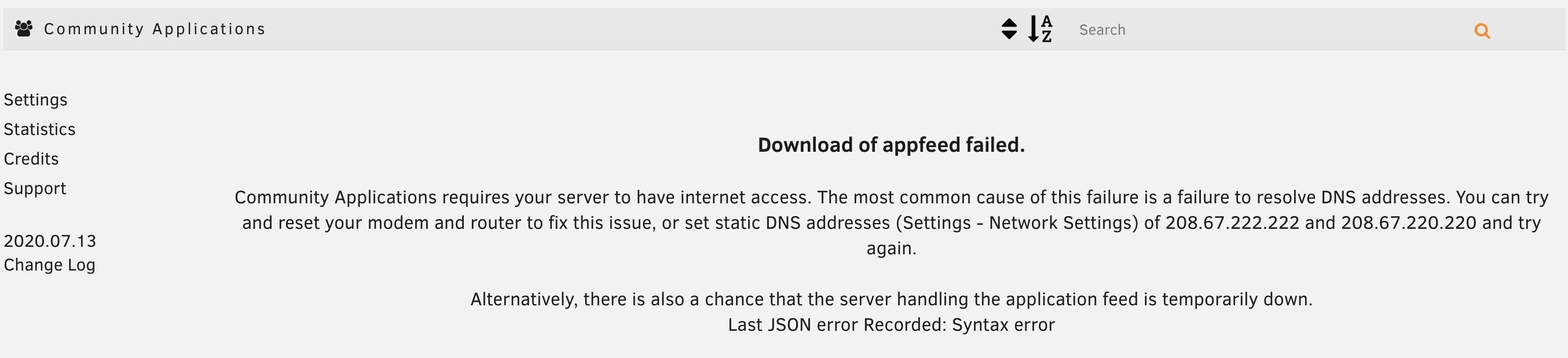

I am now getting this error too.
I have checked my DNS and everything else is resolving fine.
