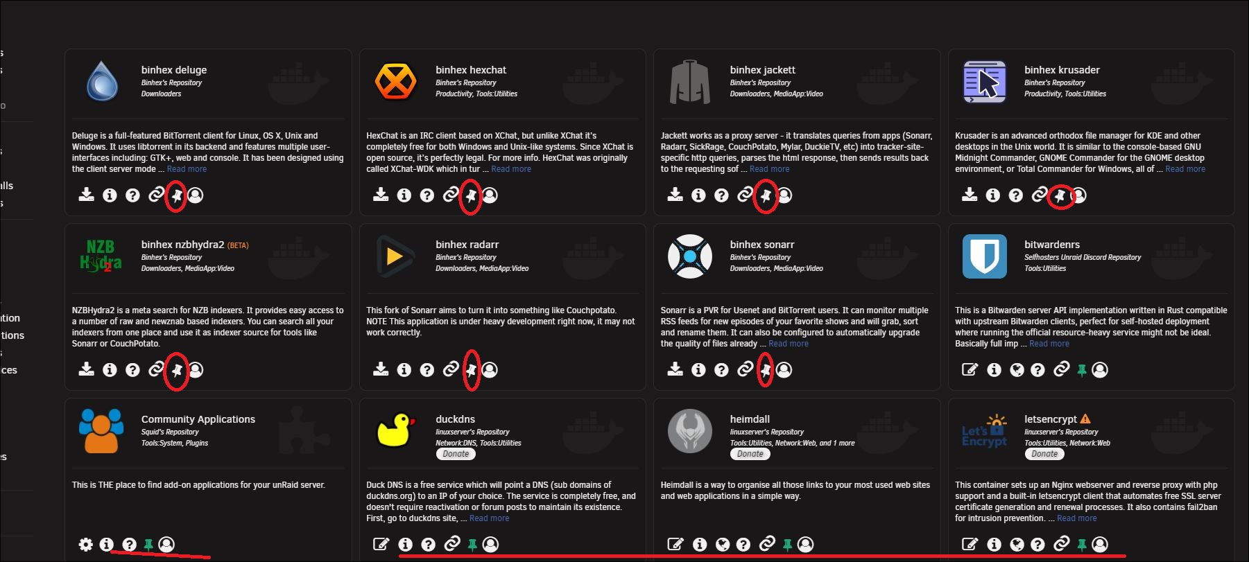

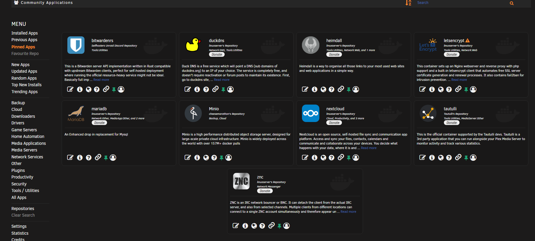

latest update behave the same as preview one regarding pinned application.
basically applications or not all application are pinned, even if they do show as pinned under installed, not all show in pinned apps
Shouldn't be any issue with CA and this, barring something up with the flash drive.
Try deleting /config/plugins/community.applications/pinned_appsV2.json from the flash drive and try again.

Maybe I'm confused.  There's a difference between pinned apps and favourite repository.
You can have as many apps as you want pinned to appear in the pinned apps section.
Favourite repo there is only 1, and whatever you have selected as the favourite shows up first in any category / searches etc.
Link to post

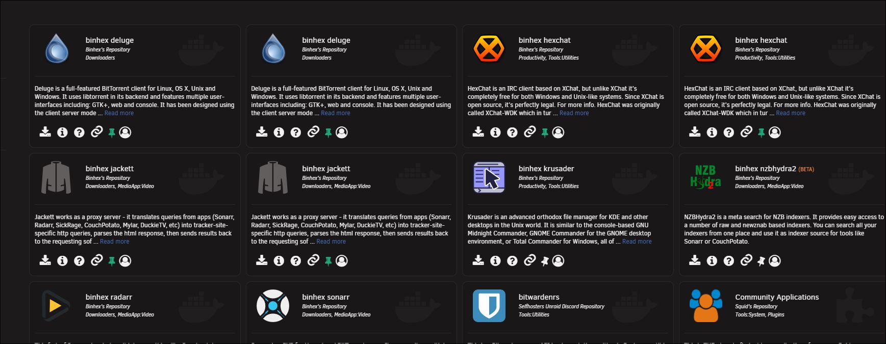

that is what i try to say, i have 19 pinned apps and only 9 show in the pinned tab, i have no favourite repository added, have a look at the pinned_appsV2.json i added (they are in the file) but they do not show in the tab
Edited by Danuel
Link to post
ok.  I see what the problem is.  I'll work on a solution.  The issue is your previously pinned binhex apps are stored in the file slightly differently than how they're now supposed to be, due to the "branding" removals.
Your easiest solution is to delete the file and repin the apps.
Link to post
You didn't delete the file and then re-pin the various apps.  But, I see what the problem is, and will work on a solution.
In the meantime, what you want to do is edit that file (if you don't want to re-create it) and where it says (as an example)
binhex/arch-deluge&binhex-deluge
change it to
binhex/arch-deluge&binhex deluge
ie: change the dashes in the left hand side to instead be a space.
This is related to the "branding" removal introduced a couple of revisions ago.
i did delete the file, that why i made the replay and did not work.
and i can confirm editing the file as suggested  is working, thank you ..:D
Trying to understand why deleting the file didn't work.  Did you delete, then re-pin, and then update CA?
Link to post
i only delete the file and re-pin, i did not done any update since was to the latest version ...but i can try doing that.
to delete community application from drive and reinstall ..
Link to post
so deleting Community Applications also delete from flash drive config/plugins/
when pinn the application i am back to step 1 where only few show up , at the moment single work around is to manually edit pinned_appsV2.json this is working.
i saw something interesting, the pinned apps that i edit in the pinned tab do not show as pinned, but they appear in the pinned tab, but if i pin that app from pinned tab, will create a duplicate and when removed, apps still visible in the pinned tab, but in the pinned_appsV2.json will show as false. i though you want want to know this
pinned_appsV2.json
Edited by Danuel
