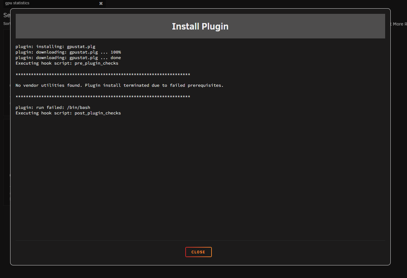

56 minutes ago, flyize said:
Oh duh. Sorry 6.11 RC2.
Reboot
Then try again.   Don't close the popup and then copy and paste the output of it.
(I can't replicate so need to see who's not doing their job: the OS or CA)

2 hours ago, Squid said:
Reboot
I don't get a popup. Are there logs somewhere?
edit: FWIW, I am able to install other apps. Only GPU Statistics goes to 'pending'.

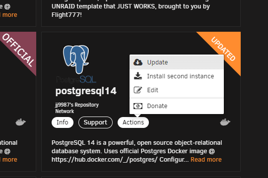

I have postgresql14 installed and it seems it got into a weird state, I can see both on the docker and apps page that it's got an update, on the apps page I get the Update and Edit choices but Edit pops up "XML file was missing" and Update gives "Configuration not found. Was this container created using this plugin?", what's the best way to fix it without losing settings?
EDIT: Found the XML in my Jul 27th flash backup and restored it, but no idea why it disappeared...
EDIT2: I remember now, it showed up in "Previous Apps" and I deleted it from there since I thought it was another template I had installed before settling on that one, but no it was the live one. So now the question is why did it show up there...
Edited by Kilrah
Thanks.  Not a bug as you discovered, but I'll handle that circumstance in the context menu
Well it's still weird that something in use ended up in "previous apps", but I doubt I can provide useful data given it happened a week ago :(
