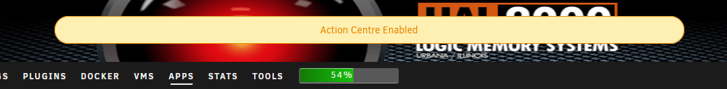

I keep getting this banner at the top of my server on page refreshes/loads. I get it, it's enabled. How do I get the banner to stop showing up?
You click on the Action Centre on the left and apply the updates.
