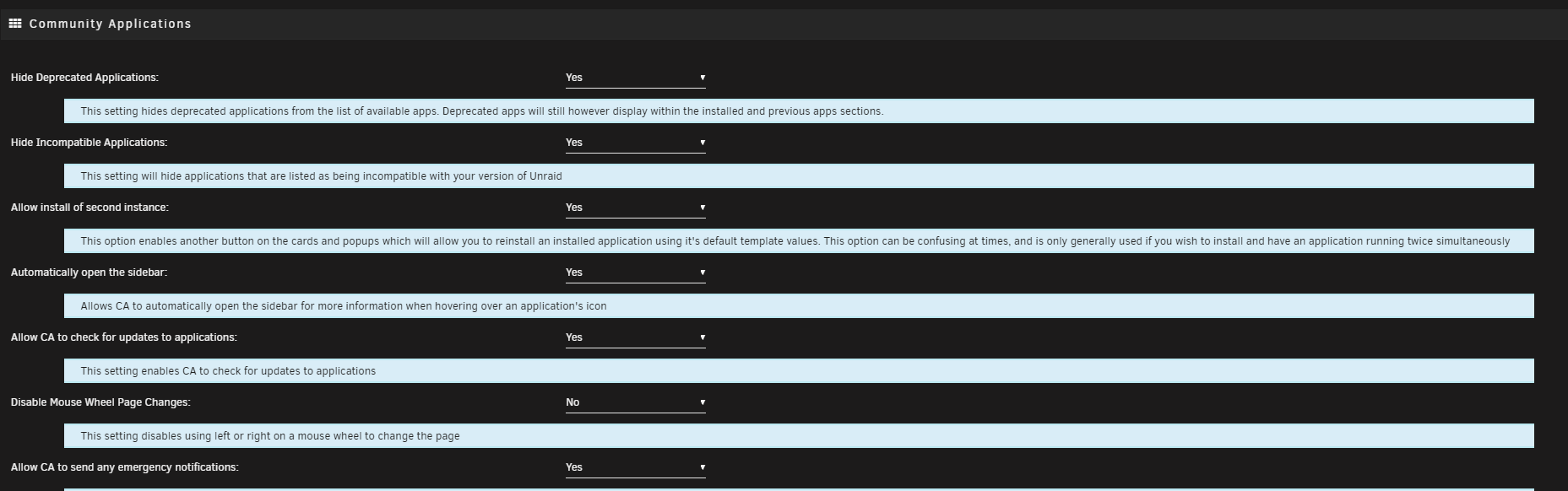

Is it supposed to look like this everywhere now or is it a different plugin? So hard to follow going side to side on entire screen:
I think you have turned on global help. Click ?
:facepalm: and you'd be right..thank you..sigh. Thanks!
Aren't you glad it's not supposed to look like that.😁
