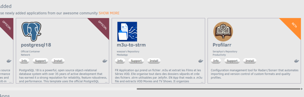

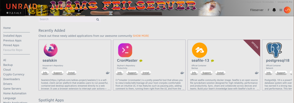

a few updates ago, the plugin got some cosmetic changes, which I find rather annoying:
The start page now contains more icons that can fit onto the screen and add side scrolling rulers
(not shown here, they appear if you hover below the first row of icons and "recent apps")
This cuts off the rightmost icons, you have to know that 2 more are there and need to hit the scrollbar to see them.
And because the scrollbar only shows up if you put the mouse over the right spot, it took me some time to find it at all.
Anyway, it now takes ages to see the whole line
And you need to repeat these steps for every single section that comes below
This is really annoying and no help at all.
Think of showing less items per section, make the boxes smaller or something else.
Just get rid of these scrollbars please.
btw: this only happens on the "home" page of the plugin. Every other page nicely only show 3 items per line and does not need side scrolling!
Here's how the system worked before. CA would generate 12 cards for each section (Total of 72 cards generated and rendered). Overflow was hidden on them so that you'd only see the total number of cards that would fit in your browser, but if you resized the browser or lowered the zoom etc you'd see them all (12 was chosen as it fit on the 49" I had at the time)
With responsive and mobile, this resulted in ton of wasted CPU cycles on what are generally low power devices. The scroll bar solves everything, but it is limited now to 6 per section.
The alternative was to determine how many cards will actually fit on the screen. This however involved a ton of forced reflow issues in the browsers which resulted in very noticeable slowdowns across all platforms.
What browser are you using? I don't see that on any of my systems -> the scroll bar is always present
Firefox.
as you can see from the 1st screenshot, there is no visible scrollbar until you hover over that region.
Just make it 4 only, these will fit if you make them as small as on the other pages.
And maybe consider to add a switch to the setting to turn off this totally uncessary "responsive and mobile" completely. Just add a "columes" setting so the user can set his own desired width.
Edited by MAM59

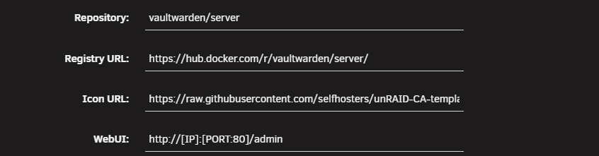

what "drives" the "store"/"store registry" to know if a docker container/app is installed
all my apps and dockers are reflected correctly except for Vaultwarden
i have not changed the registry or repository details
it IS installed and IS working
but the store keeps showing it as not installed
i have uninstalled and re-installed 3x now
this is problematic as i never know if there are updates
i keep having to check and re-install
there must be an eroneous value somewhere that can be corrected
below is screenshot of store and docker and registry etc..
please help
The container name. Looks like you capitalized the V.
Should show in the Action Center anyway when there are some. And the Docker page of course.
Edited by Kilrah
Should show in the Action Center anyway. And the Docker page of course.
seriously? its based on the container name?
not the registry
you need to keep it exactly as is?
yes it is in docker and working
yeah, that worked
that is crazy
my OCD does not like UnCapitalized titles
i would have assumed it was based on the registry
is there some sort of "wish list" where we can make a request of sorts
if thats the case then maybe there can be 2 boxes
docker name and display name
you would think it works based on registry or something
and if not have an option to display using a different name
additionally, you would think there would be a warning when you change the name, if thats how it works
Edited by charettepa
It's intentional, so that if you e.g. want to install 2 instances of a container you can just name one differently, then it's offered for install again instead of showing "installed".
But there should be no reason to look at the main CA page for updates, it'd be a stroke of luck for what's featured there to happen to be something you installed, most of your stuff won't show there. Right places to look are the Action Center page in CA and Docker page.
Edited by Kilrah
the problem is that
when its like that
it never tells you an update is available
the last 3 vaultwarden updates never showed as "update available"
i assumed it was because it did not know it was installed
the only way around it was to redeploy
and it would pull the new image
are you saying thats a different issue and should not have happened?
No that would be unrelated, update check is based on the repository:tag, name doesn't matter.
so why is it that only this container never gets any update notifications
and i must redeploy to get it
i know there is a new one as i am registered for updates on that package from docker hub
i even waited a few days last time and still
it kept saying "up-to-date"
Looks like you just reinstalled the same thing even when you did anyway.
vaultwarden/server as repository pulls the "latest" tag. This app's publisher hasn't updated that tag in 4 months.
https://hub.docker.com/r/vaultwarden/server/tags?name=latest
So it seems that this app simply has had no updates to stable/latest for a while, so nothing for you to get unless you switch to the "testing" tag that would presumably not be for production use.
Edited by Kilrah
you are 100% correct
i just checked their page and scrolled back 4 months
TAG
1.34.3
Last pushed 4 months by vaultwardenbot
they have been pushing lots up updates
but not updating the latest tag
not sure what all the updates are
as if you go to danigarcia's github
which is the dev his lates is 1.34.3
not sure why there are a ton of newer released on dockerhub though
thank you for your help with this
