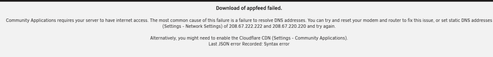

I ran into the same “Download of appfeed failed / Last JSON error: Syntax error” problem on CA 2026.07.21 and did some digging. Posting the diagnostics in case this helps anyone else with a similar ISP/network issue, or if CA can handle this case more gracefully.
DNS and general Internet connectivity are fine. ca.unraid.net resolves correctly and other HTTPS sites such as GitHub work normally.
The problem is specifically traditional TLS over TCP to ca.unraid.net.
A normal request:
curl -4 -v https://ca.unraid.net/assets/feed/applicationFeed-lastUpdated.json
fails during the TLS handshake with either:
SSL routines::wrong version number
or:
Connection reset by peer
I tested the individual Cloudflare destination IPs directly with --resolve, so this is not a DNS-resolution problem.
The interesting part is that an OpenSSL debug capture shows why wrong version number occurs. After sending a TLS ClientHello with:
SNI = ca.unraid.net
the connection receives plaintext HTTP (HTTP/1.0 200 OK) instead of a TLS record, apparently from ISP filtering/interception infrastructure.
Connecting to the same Cloudflare IP without the ca.unraid.net SNI instead receives a genuine TLS response.
I also tested from a completely separate mobile ISP. Using the same Cloudflare IP and ca.unraid.net SNI, TLS succeeds normally:
CONNECTION ESTABLISHED
Protocol version: TLSv1.3
Peer certificate: CN=unraid.net
Verification: OK
and a normal curl request returns:
HTTP/2 200
server: cloudflare
So the problem appears to be ISP/path-specific handling of normal TLS/TCP traffic to ca.unraid.net.
HTTP/3 is unaffected. From the affected connection:
curl --http3-only https://ca.unraid.net/assets/feed/applicationFeed-lastUpdated.json
returns:
HTTP/3 200
PHP's libcurl on Unraid also supports HTTP/3. I tested the CA endpoint directly using:
curl_setopt($ch, CURLOPT_HTTP_VERSION, CURL_HTTP_VERSION_3ONLY);
and got:
errno: 0
HTTP: 200
body: {"last_updated_timestamp":...}
As a temporary local test, I modified CA's download_url() so that requests whose host is exactly ca.unraid.net use CURL_HTTP_VERSION_3ONLY.
Community Applications immediately started working normally again.
So in my case the comparison is basically:
ca.unraid.net over normal TLS/TCP  -> intercepted/fails
ca.unraid.net over HTTP/3/QUIC     -> HTTP 200
same TLS request over another ISP  -> HTTP/2 200
CA forced to HTTP/3                -> Apps works
I have reported the false-positive/interception issue to my ISP.
Would it make sense for CA to retry the feed using HTTP/3 when the normal TLS/TCP request fails, assuming the installed libcurl supports it? Alternatively, could there be a fallback feed on a genuinely independent hostname?
I noticed the July changes removed the GitHub application-feed fallback, so users behind ISP filtering or other path-specific problems with ca.unraid.net no longer have that independent fallback. I realize this is ultimately an ISP problem, but an automatic HTTP/3 retry/fallback could make CA more resilient to it.

Hi all,
Is there anyway to overcome this issue? Contacting my ISP was pointless, as they don't have anyone smart enough to understand that it's an issue from their side.
Thank you.
Error:
Download of appfeed failed.
Community Applications requires your server to have internet access. The most common cause of this failure is a failure to resolve DNS addresses. You can try and reset your modem and router to fix this issue, or set static DNS addresses (Settings - Network Settings) of 208.67.222.222 and 208.67.220.220 and try again.
Alternatively, you might need to enable the Cloudflare CDN (Settings - Community Applications).
Last JSON error Recorded: Syntax error
2 hours ago, HAMANY said:
Hi all,
Thank you.
Error:
No guarantees here, but If you went to Settings -> Network Settings in Unraid and manually set the DNS Servers to the ones listed and it still fails, try setting DNS server 2 to 1.1.1.1 or 8.8.8.8 and see if that helps.
Tried that already, unfortunately it didn't work.
I've used the AI to investigate, the conclusion was that I was not able to reach the subdomain (ca.unraid.net) through TCP, however the HTTP works fine. It's blocked from the ISP level.
Troubleshooting:
curl -sS -o /dev/null -m 15 -w '%{http_code}\n' https://ca.unraid.net/assets/feed/applicationFeed-lastUpdated.json # Fails (Works with VPN only)
curl --http3 -sS -o /dev/null -m 15 -w '%{http_code}\n' https://ca.unraid.net/assets/feed/applicationFeed-lastUpdated.json # Works
Troubleshooting:
Thanks for the tip from @yaharga , modifying CA’s code has fixed the issue (it’s basically a workaround).
This is a step-by-step guide. Follow it at your own risk; it was created by Claude.
https://claude.ai/code/artifact/7e6deebd-68c7-4d8c-989e-dd8c75f38aa5
Edited by HAMANY
For me it was ubiquiti blocking access to the page. Maybe some firewall rule on your side as well?
In ubiquiti under Settings > Cyber Secure > Content Filtering i added ca.unraid.net to the allowlist and it worked fine.
I've already check the firewall and DNS server. The issue was confirmed to be from the ISP.
Several friends of mine using the same ISP with different routers/firewalls have the same issue.

I woke up to this today. I haven't made any changes to my network or server in some time. Some guidance would be appreciatedimage.png
Check this post. The guide has some troubleshooting steps.
I also am using Ubiquiti gear, CGM. I tried adding this to the whitelist filter, doesn't see it as a valis web address.
Thanks so much, this was my issue too. I had Unifi's own Adblock enabled which was blocking ca.unraid.net. I added ca.unraid.net to the Adblock's Allowlist.
Thanks, this was my issue too. I am using my UDM's own Adblock ruleset and it was blocking ca.unraid.net. I added it to the Adblock's Allowlist and it worked again.
Which ISP? I have Spectrum internet.
I also just recently started having issues accessing Community Apps. Adding ca.unraid.net to my allow-list in my Ubiquiti dashboard (settings->Cyber Secure->Content Filter) fixed the issue for me.
Edited by ElTedChuck
I have been working through this error for the past couple of hours :
The issue ended up being my PiHole (I run 2). Something with the upstream DNS servers was not working correctly, so I changed them to Cloudflare and OpenDNS. As soon as I changed this it immediately started working. Hope this helps!
only ca.unraid.net, no https.
Appearently it never did save my settings. Works now, thanks.
Edited by gadget069
You are a life saver!
